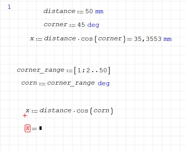

Dear
I have problem with rank along with unit.
Par example: x = 50mm * cos (30 deg) = 35,35mm
But when I use range corner = 0,1,2...50
x = 50mm * cos(corner) don' work!
I try with vector, but it don't work.....
Thanks

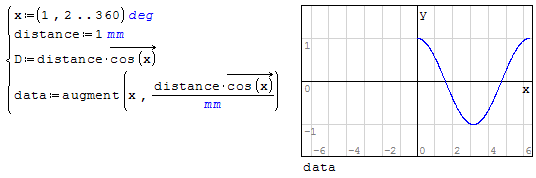

#2 Опубликовано: 05.08.2021 04:33:03
in fact, the solution has already been given to you.
cornerRange.sm (6,1 КиБ) скачан 1192 раз(а).

If you pay attention to the others solutions, you missed the VECTORIZE function
