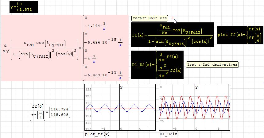

I've put together these calcs that anaise the vibrations in a transmission support fram that I have a
Cardin Shaft FD1 -Trans 180125.sm (861,77 КиБ) скачан 1677 раз(а).
#13 Опубликовано: 25.01.2018 11:54:38
Fellas,
When you carry units, you may have recast some part unitless so you can keep track.
I have only doctored the 1rst & 2nd derivatives plots.
Cardin Shaft FD1 -Trans 180125.sm (878,26 КиБ) скачан 1596 раз(а).

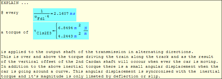

#14 Опубликовано: 25.01.2018 12:51:31
Smath does not have the option to insert math region in text region.
You can still publish nicely, otherwise.
In the attached [2], the "Formated label" is incorrect vs Smath 6179.
The word EXPLAIN should replace the image RGBY square, as title
Cardin Shaft FD1 -Trans 180125[2].sm (883,49 КиБ) скачан 1455 раз(а).

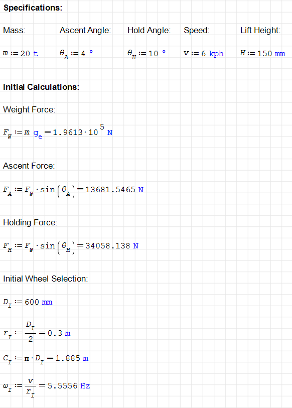

Ok, I have read a little bit on this thread, but I am still very confused. SMath is showing me that rad/s and Hz are equivalent. I would like to be able to calculate angular velocity as w=v/r and setting the units to rad/s. I understand that they are dimensionaly the same, but surely the rad/s to Hz conversion should include the 2pi factor?
#16 Опубликовано: 29.07.2025 09:48:34
Jago
Jago
my full working so far for referance so you can see where it has tripped up (the last line).

I hope that section 3.5 of the attached document contributes to clarification of the situation.
Introduction to SMath Studio.pdf (1,18 МиБ) скачан 6371 раз(а).
