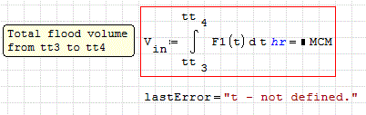

integral isn't calculated in this example. Culprit is maxima plugin. If it is installed you can't get a result.

http://en.smath.info/forum/yaf_postst7429_Definite-Integration-of-the-Exponential-Function.aspx
Thanks. This has been discussed.

Integral works for me:
You are totalising an hourly rate of accumulation
over the [a,b] time limits for a total MCM [m^3]
