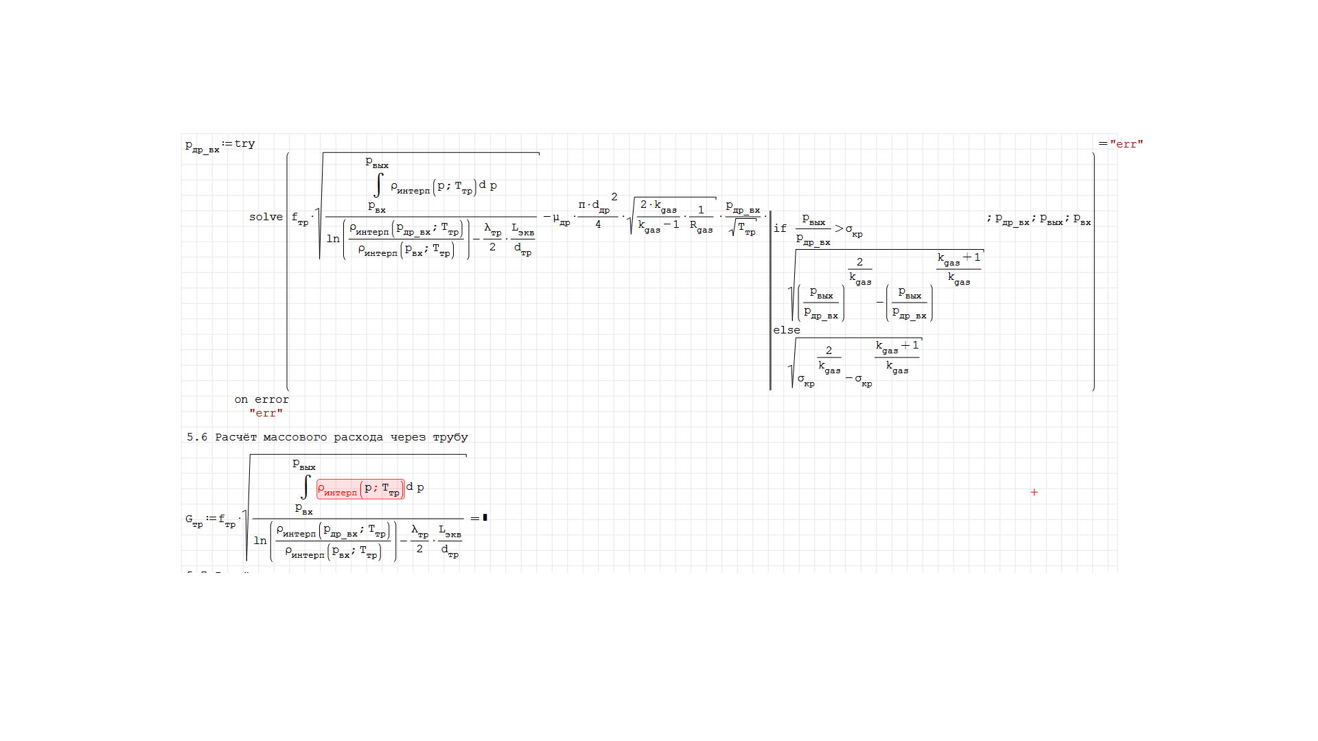

For a long time I can't solve the problem in this program, I can't find the roots
Project
Raschet propusknojj sposobnosti truboprovoda s drosselem na vykhode.sm (1,44 МиБ) скачан 1198 раз(а).
Please help, I know you can

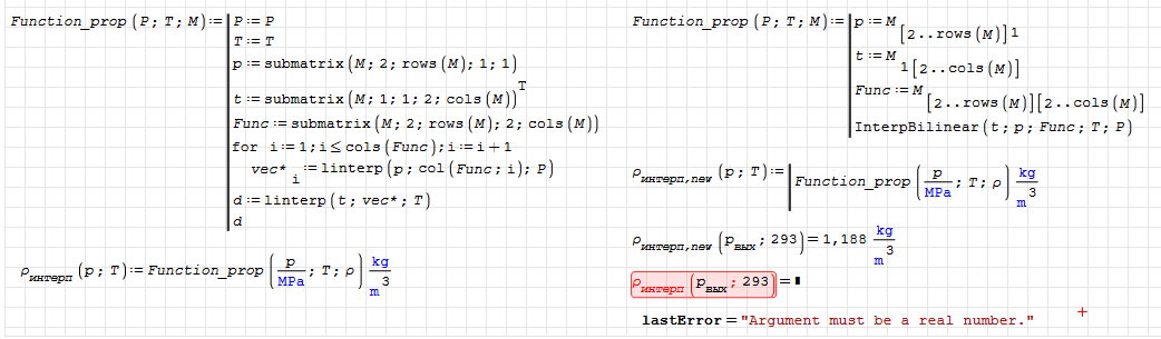

#2 Опубликовано: 11.03.2020 15:01:10
The first error message is in Function_Prop
It says "must be a real number" ?

I fixed Function_Prop using InterpBilinear() from the Statistical Tools plugin. Note that the definition without line operator behaves buggy, because you even won't get the usual storage preview when hovering over the definition. This is strange and indicates something really bad under the hood.
Yet fixing the function doesn't solve any of the problems downstream. But given the strange error messages and bugs I'd say build 7251 can't be used safely anyways.
BTW, instead the if-else cascades I'd recommend using the selection index as index of a vector of options.

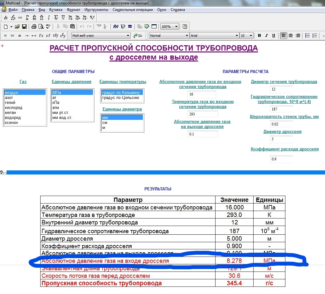

The answer does not match, it might be better if I attach a file from MathCad. I have to translate the program from MathCad to SmathStudio, but sometimes I get errors like this.
Raschet propusknojj sposobnosti truboprovoda s drosselem na vykhode.xmcd (487,33 КиБ) скачан 1189 раз(а).
Here is the answer, sorry, that in Russian
