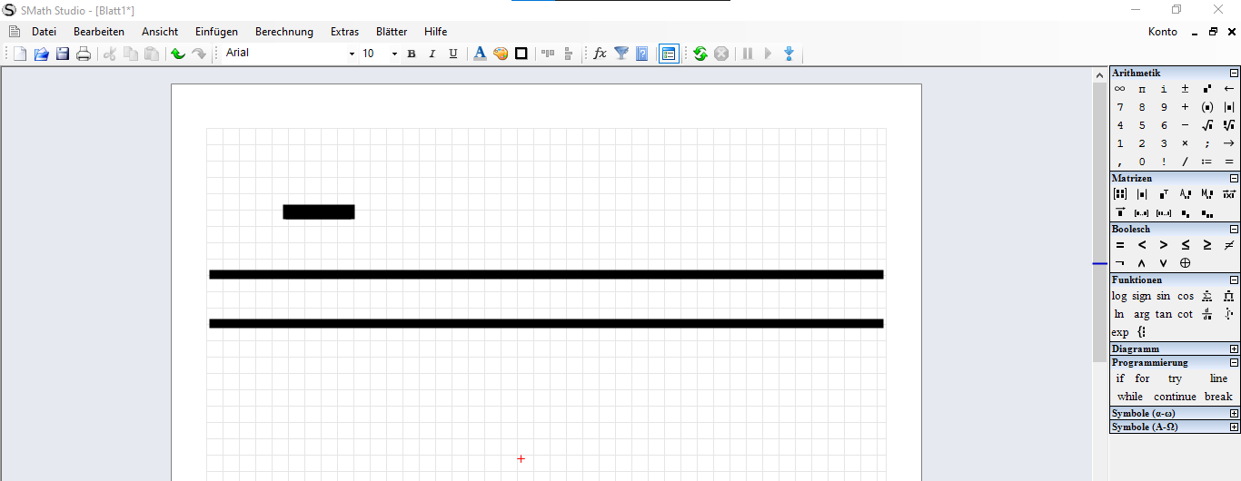

Hi
While working with SMath everything is covered in black, see picture below.
Even older files are shown in black and I can't use them anymore.
I already reinstalled SMath.
Thank you in Advance.
This freak is quite old wrt versions.
Select all, click background white.
It may come back black again, a pen in the ass.
Try it ... report ... a real bug !

Thanks for your kind answer,
what a beautiful atmosphere here.
Well that worked, sometimes the thoughts are somewhere else, but it should never stop you from being kind.
