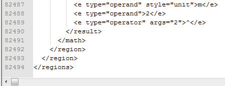

Trying to reopen a file that I wrote and that refused to be closed normaly, I receive this message:
"Unexpected end of file occured.
The following elements are not closed:
result, math, region, regions. Line 82490, position 12."
I posted the file here:
file
Is it possible to recover the file ? If yes, how ?

The problem might be solved by just closing the xml tags in the file, but I can't try...
The solution is indicated by mkraska and the result is in the attached file

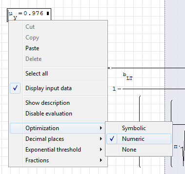

all results are in fractional mode, against my temptatives of changing.
#6 Опубликовано: 03.07.2012 07:18:06
You are welcome
simply change the result optimization from "none" to "numeric"
regards,
w3b5urf3r
