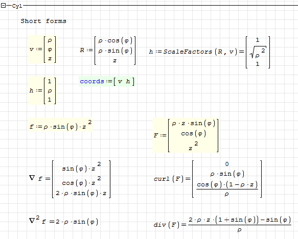

Hi. Example about how to get vectorial differential operators in a curvilinear coordinate system.
coords.sm (86,5 КиБ) скачан 1336 раз(а).

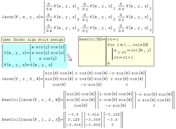

As an application of these comments, I have this suggestions
- Add "nabla x" and "nabla dot" like grad and lapl to custom gliphs
- Same thing, but for several variables and vectorial integrals (path, flux, etc.)
- Improve at function for handling v=P where v and P are vectors (see green comments in the attached)
- Make custom gliphs and include plugins internal
- If include can't find in the sm file in the same folder than the current file, nor the specify path, search it in some "library folder" under apps default path.
- The set of 'libraries' could be a plugin itself, and have some kind of actualization, like the others plugins, examples or handbooks.
- In the attached, the 'library' style for the differentials applications, and help for get a large collection of coordinates systems, if in case that same one want to write the 'library'
coords v2.sm (110,26 КиБ) скачан 1272 раз(а).

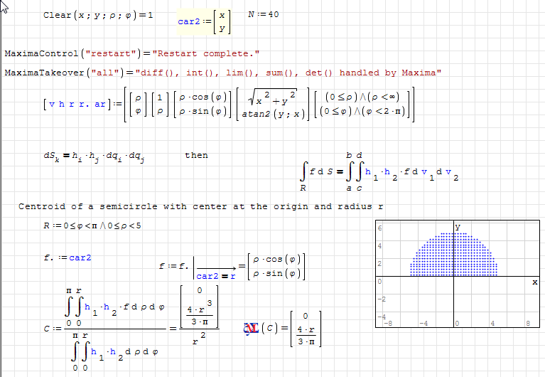

Hi. Some few samples.
Integral in polars.sm (48,38 КиБ) скачан 1257 раз(а).
frapuano 07.12.2018 15:15:00
#7 Опубликовано: 07.12.2018 15:18:58
Thanks Alvaro: works great

Polar integration in symbolic version:
Integral%20in%20polars_Kr.sm (57,53 КиБ) скачан 1423 раз(а).
frapuano 11.12.2018 13:30:00, Arie 11.12.2018 13:51:00, Alvaro 11.12.2018 17:45:00
