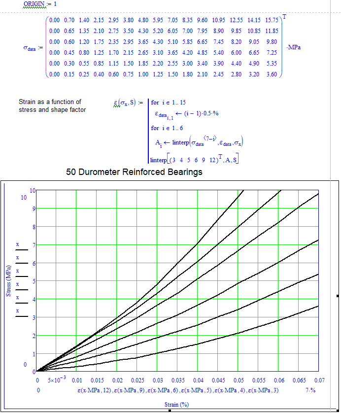

Question: Below is a screenshot of a 2D plot I can pull off in Mathcad. Does Smath studio have the ability to do similar? I was looking in the wiki and other examples, it seems as if they might be an option, but I can't find anything for defining X-Y plot limits. I think I can pull off the multiple lines with the System of Values smath command, and get each of those durometer lines at 12, 9, 6, 5, 4, and 3. But I am struggling with getting it to plot anything at all.
Mathcad:

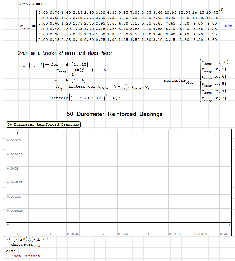

What I have in Smath so far:
FYI, I use Sigma.comp in several places in the worksheet, and it returns expected values. So that definition and the linear interpolation is functioning properly. Thoughts?
Mathcad:

Try X-Y Plot Region and attach the document.
WroteTry X-Y Plot Region and attach the document.
Yes because in that one you seem missing, the boat.

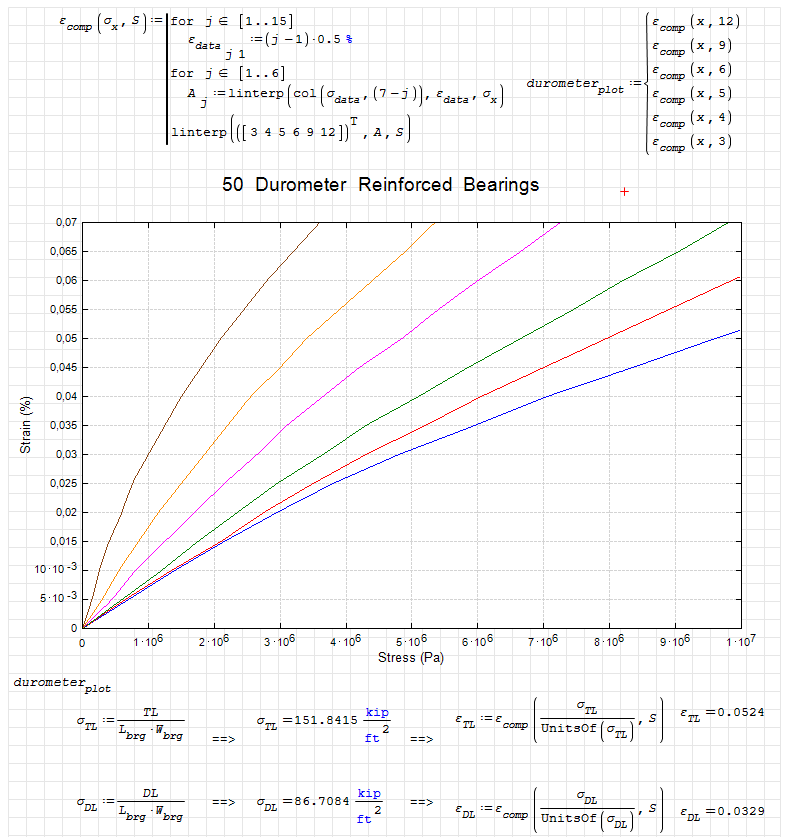

Thanks...I did not have X-Y Plot region addon. With it - I was able to get an output:
Does all that I need it to do. Only other option - see how MathCAD allows inverting access, or call Y-Axis range into equation. So I reversed position as X-Y Plot only seems to pull input from X-Axis. Is there a way to call Y-Axis?
If you attach the document I'll try to show how to invert axes.
Tabulate discrete, inverse the collection ...

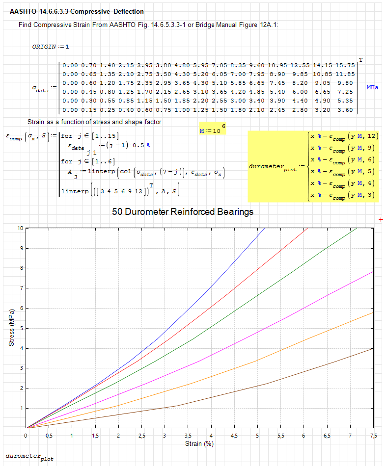

Like this. Implicit plot mode used.

You just have a data set from some standard.
You can interpolate from the 2D spline module,
as well you can plot each interpolated column.
You first have to metric each direction X Y.
