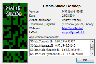

#2 Опубликовано: 08.09.2014 17:02:30
Hello E-Jay, what version of SMath Studio version are you using?

Version: 0.97 (build: 5154)
Date: 2/10/2014

I just tried to update the program. It did not appear to install the update.
I then removed the program and installed the latest version.
0.97 (build: 5346)
8/21/2014
I now receive the following message when starting the program.
ComboBoxRegion.dll
That assembly does not allow partially trusted callers.
What do I do now???
Thanks for your help.
Jay
