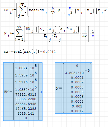

#5 Опубликовано: 10.12.2021 08:18:09
WroteAttached is sheet, this is a MRM for beam frequency analysis
Sum over 'n' ... NOT over 'k'
Model summation attached.
Function Running Summation.sm (32 КиБ) скачан 76 раз(а).

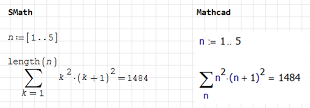

#8 Опубликовано: 10.12.2021 11:48:32
Hi. As Viacheslav says, it's better in this case the mathcad file. Just a couple of notes.
You use a for loop with i as counter. Thus, at the exit, i equals the last count value, not the entire range. So, or you redefine i as range, or use this way for not changing i value
Actually, SMath doesn't have "range" variables, it only have scalars and matrices. But mathcad have "true" range variables, which it's more a complication than an adventage. BTW in SMath you can't use a range variable in the same way, and sometimes needs some dummy variable for detect them
Finally, remember that in mathcad sqrt(-1) is 1i, but in SMath it is just i, so using is as counter you loose all the complex algebra.
Bests regards.

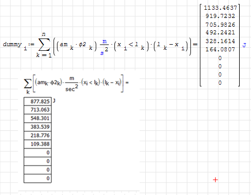

#9 Опубликовано: 10.12.2021 12:30:05
WroteJean, I am at a loss as to which part of your file I should be looking at.
It just shows how to run summation wrt several dependent functions.

#11 Опубликовано: 10.12.2021 13:46:48
WroteHi Jean,
OK, now I understand, just some pointers for me
Thanks
Ian
The A,B are numerical two vectors of coefficients.
Then introduced in the scalar function wrt sin/cos.

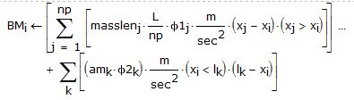

#12 Опубликовано: 10.12.2021 15:00:17
WroteI am trying to convert a Mathcad 15 sheet, and have a problem with the below equation:
I think that there should be such a replacement.
