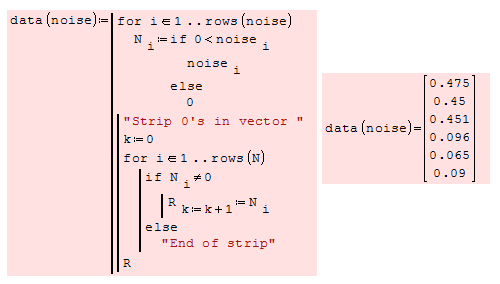

It's possible to block the negative input in field's using smath viewer ?
Pretty simple to zap negative values:
1. transform negatives to '0'
2. strip vector from '0'
No need using Smath Viewer.
Cheers ... Jean.
Random [rnd(n)] Filter.sm (10,03 КиБ) скачан 960 раз(а).
Composite clean negatives.
Thanks Jean, but it's not the case.
I have an long application developed in Smath Studio using Smath Viewer, and some of my algorithms need's a positive input for bending moment's. For now showing a warning message, and using an absolute value work, it's not the more elegant solution, but work.

I have an long application developed in Smath Studio ... , and some of my algorithms need a positive input for bending moment's.
The very original document at the algorithms level might help.
Not my discipline, but curious.
Refreshed version of the previous Filter Negatives.
Jean.
Random [rnd(n)] Filter.sm (10,07 КиБ) скачан 961 раз(а).
