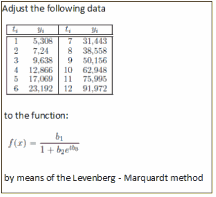

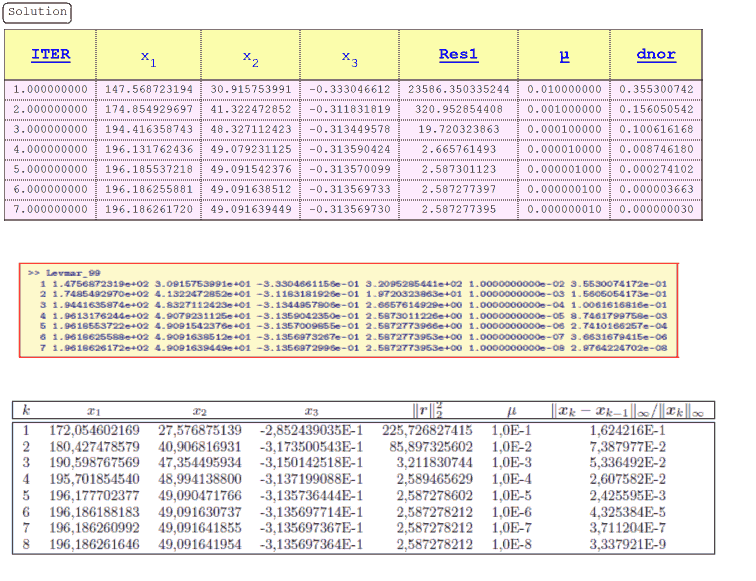

Levenberg Marquardt Method - A simple sample of the application of the Levenberg Marquardt method - Сообщения

Thanks Carlos,
For meditation. Hover the pointer on φ(x,β) to see Conjugate Gradient.
The model is puzzling, if you want so: can try expGrow as an exercise.
