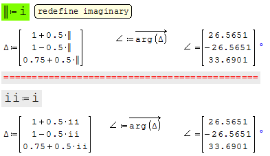

Can we have another imaginary unit?
an "i" with two vertical lines?
When I solve electric circuit problems I have to use "c" for current.
Thank you,
Basile
an "i" with two vertical lines ?
Like this Basile ... Cheers Jean

I believe that a code solution is needed for i, π, e, etc.
Basile

Thank you Jean.
Basile
I don't vote to freak 'e, π'
Like ... sin(x)^2 ► sin²(x)
#6 Опубликовано: 21.03.2023 07:25:44
You are correct, you shouldn't redefine some constants globally by editing a setting file.
Only option is adding variable defining codes to start of your worksheet.
