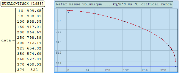

#7 Опубликовано: 14.07.2020 18:57:47
WroteHarvey,
If you wish, you can exercise your cubic(s).
The red fit is one piece.
Although this thread has deviated from the original subject (function errors) to the merits of different fitting functions and thermo software, I will respond with some fits to the water density data.
I don't expect the cubic polynomial to fit every set of data. In the past I have used various nonlinear functions, using genfit in Mathcad. Looking at your curve, I would probably have started with a natural log function. The first plot below shows the cubic fit and the ln fit. The latter does quite well with one term and three parameters. The cubic does fairly well except near the critical point.
The plot below shows the Prode equation used for the liquid water density. It does well through out the data range, including near the critical point. The equation does not work with a reduced temperature of 1.
Finally, I think you may have misinterpreted my intent in my last post. I described what Prode uses for data and their fitting capabilities because you had said you didn't know what Prode was doing. I was not promoting Prode.

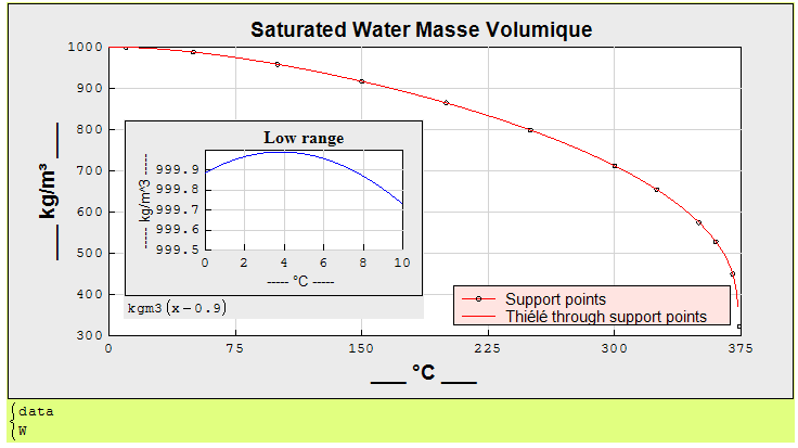

#8 Опубликовано: 15.07.2020 14:11:59
WroteThe plot below shows the Prode equation used for the liquid water density. It does well through out the data range, including near the critical point. The equation does not work with a reduced temperature of 1.
In my times, Prode was the Air Liquide Bible, in English too.
I have the water rho IAPWS from B. Spang in Mathcad.
Very many data sets have model(s).
Otherwise, we rescue via interpolation methods, mostly:
1. Padé normalized rational fraction.
2. ChebyShev linfit.
3. Thiélé inverse interpolation.
4. Piece wise LSQ [can't make it work Smath].
5. Convolution Polynomials [Laser].
Some data set can only be fitted by hand [Chemist].
All that said in short, why not re-thread to be more attractive ?
Prode Discussion would attract greater audience.
Genfit Chemist.sm (34 КиБ) скачан 50 раз(а).
