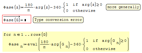

#5 Опубликовано: 22.05.2018 10:58:42
... more general definition of phase:
Project Admittance Copy.sm (155,54 КиБ) скачан 1258 раз(а).

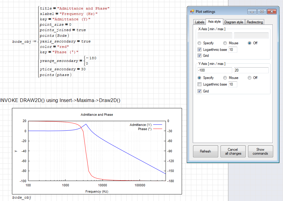

#6 Опубликовано: 22.05.2018 13:32:28
Arie
Arie
Figured out how to use Maxima's Draw2D(). This also looks nice for a logx plot. Plotted both Admittance and Phase in same graph. I like this as well because properties can be changed directly in SMath sheet.
I played around with XY Plot but was unable to find a way to use log axes.
Project Admittance Copy_Maxima_Draw2D_alyles.sm (183,41 КиБ) скачан 1387 раз(а).

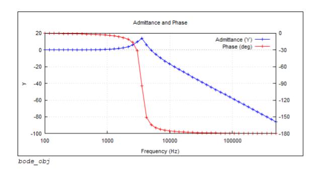

#7 Опубликовано: 22.05.2018 13:55:59
Nice example!
I did a bit of cleanup, removed the markers and shifted some options to the settings dialog.
2018-05-22 18_50_32-SMath Studio - [Project%20Admittance%20Copy_Maxima_Draw2D_alyles_Kr.sm_].png
Project%20Admittance%20Copy_Maxima_Draw2D_alyles_Kr.sm (97,31 КиБ) скачан 1514 раз(а).
