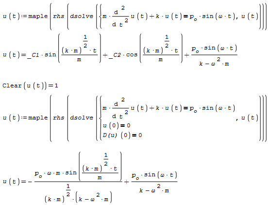

Thank you. How do you input ",u(t)" in the brace?
#6 Опубликовано: 01.07.2024 13:06:09
Valery Ochkov
Valery Ochkov
Symbolic results from ODE.sm (9,74 КиБ) скачан 1497 раз(а).
I think so
dsolve( , u(t))

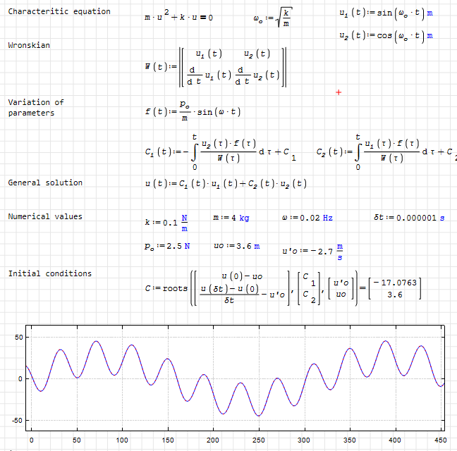

Plugin less solution, with units, using the Wronskian and the variation of parameters method.
Symbolic results from ODE.sm (23,52 КиБ) скачан 1459 раз(а).
Davide Carpi 03.07.2024 23:46:00, netsonicyxf 06.07.2024 21:09:00, sergio 15.07.2024 15:16:00
