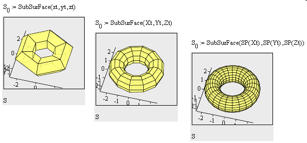

Presumably, I understand what you are after ...
... Create a 3D system of vertices, you need 3 matrices.
We have it in Mathcad from Russia. Even if it is possible
to code in Smath, no way to plot because Smath does not plot
stacked matrices [it does not plot matrices at all].
Smath plots matrices as image but not as 3D.

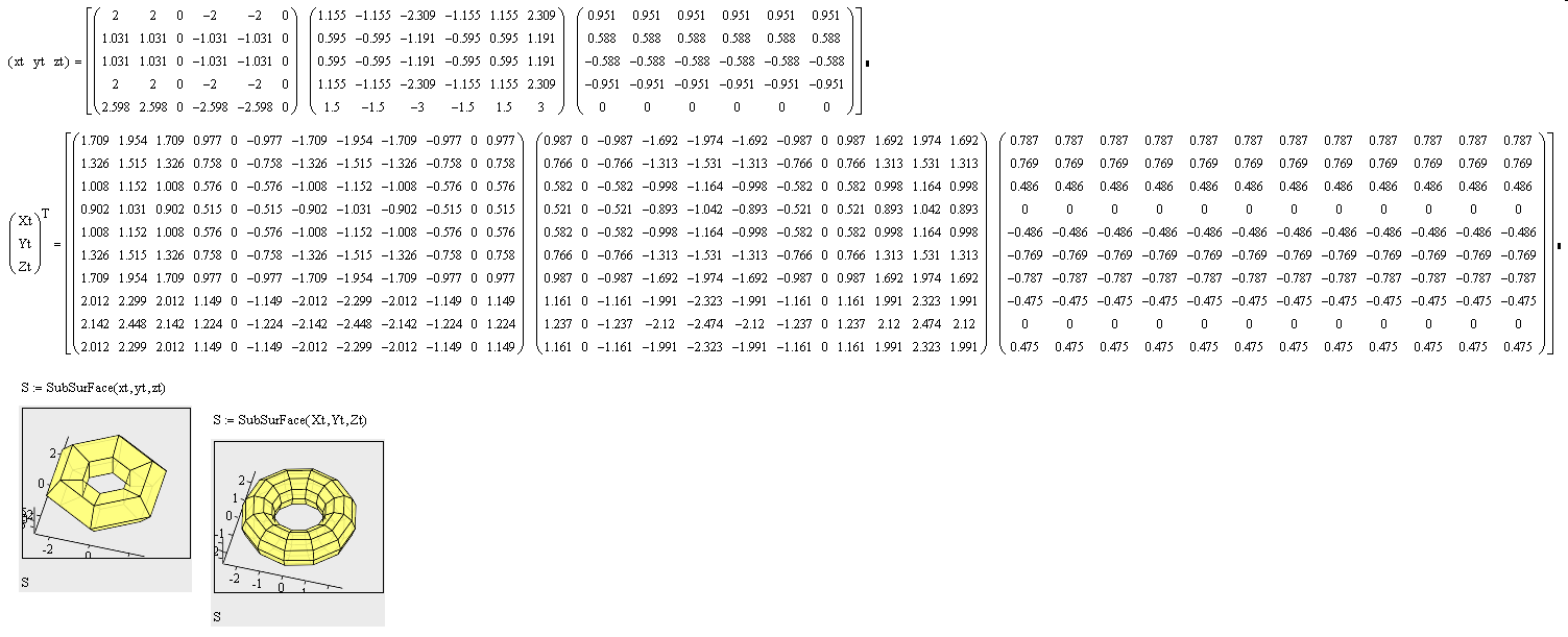

The Mathcad 11 program subdivides by 2 each step from
the Catmul-Clark B_Spline. On the other hand, Mathcad
is on ORIGIN [0], it adds difficulty to code Smath.
In short: I can attempt to code wrt Smath ORIGIN [1].
If your base 3D system does not plot 3 stacked matrices... zap !
Chers, Jean

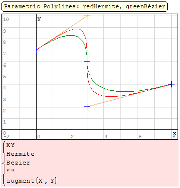

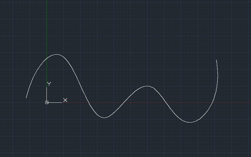

The CAD example [image] is probably Bézier parametric.
They just perform differently, especially if the end
points aren't duplicated. In other applications,
Hermite has much better smoothing properties than
DeBoor, Bézier .

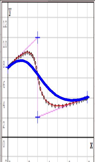

As part of our program, we can add many kinds of spline lines, but we need a spline that supports all the other KADs.
I studied the spline lines sent by you. below the picture. I also added the information that AutoCAD adds to the file for the correct display of the spline line description
black dashed line - this is because the points outside the spline line are located
pink - this is the spline line obtained by auto cadence

... from what your system shows, I guess the spline is Bézier polyline.
This type of multipoint is executed from the DeCasteljau algorithm,
more numerically stable. We can't reproduce it scalar algo style Mathcad 8.

... that confirms your CAD system is Bézier-DeCasteljau.
