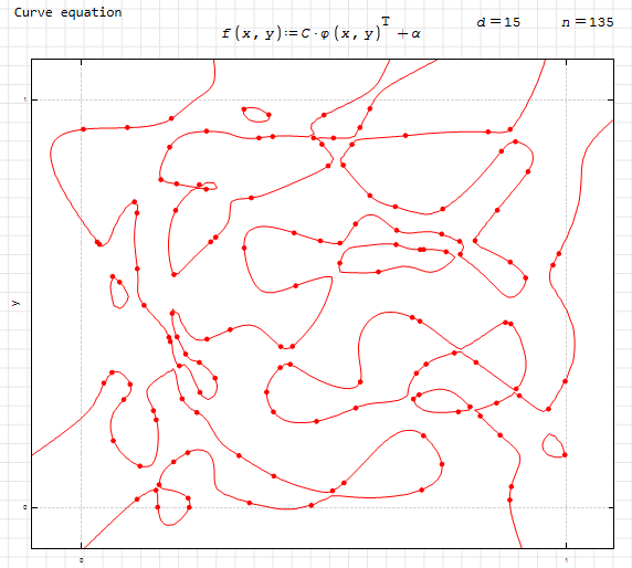

I can plot an ellipse or a hyperbola
See please Ellipse-Hyperbola.sm (11 КиБ) скачан 80 раз(а).
But cannot plot cubic lines.
Cubica.sm (29 КиБ) скачан 80 раз(а).
Is it my or SMath error?

Hi Vladimir. The problem is the poor quality of SMath's numerical code for linear algebra. A workaround is to redefine the determinant using some plugin.
Cubica.sm (31 КиБ) скачан 86 раз(а).

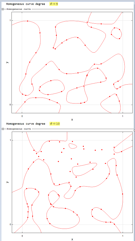

General case.
Homogeneous Curve.sm (27 КиБ) скачан 79 раз(а).

Yes, that's the sequence. It is the number of coefficients that have a homogenous bilinear form in two variables. And is the number of rows in the matrix 'v' in the file.
Limit at n=10
I put the comments backwards. For big n, disable the SMath matrix inverse method and use dn_LinAlgSolve.
Homogeneous Curve.sm (31 КиБ) скачан 70 раз(а).

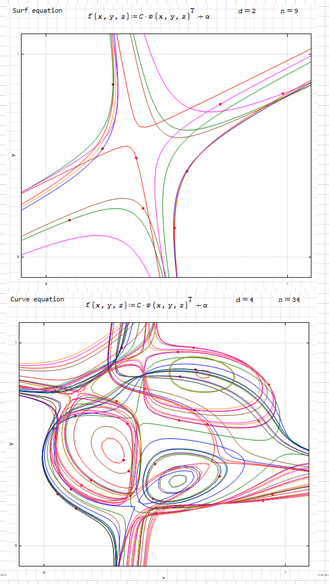

With n level curves, one passes through each X,Y pair at level Z. For d=1, we have a plane, d=2 a quadric, etc.
Homogeneous Surface.sm (33 КиБ) скачан 71 раз(а).
