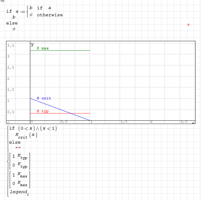

Would be interesting, why if() is not defined by default as boolean expression just like cases().
Is there any use case, where the original if() is better than the one defined with cases()? If not, then I propose to include re-definition of if() in the custom functions plugin.
Hi Martin. Yes. Here one: https://en.smath.com/forum/yaf_postsm34552_Custom-Functions-plugin.aspx#post34552
and here the Davide answer about that: https://en.smath.com/forum/yaf_postsm34559_Custom-Functions-plugin.aspx#post34559
I also remember some other about what complex could be the expressions in cases(), but can't found that.

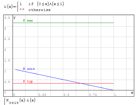

#8 Опубликовано: 22.03.2022 09:26:54
... doctored for convenience.
Observe collected plot, easy to manage.
Cheers ... Jean.
SpecialPlotsBug DOCTORED.sm (10,86 КиБ) скачан 1550 раз(а).

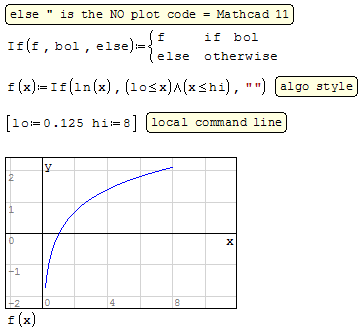

#9 Опубликовано: 22.03.2022 11:42:00
... you make Bolean algo style
for convenient command line.
