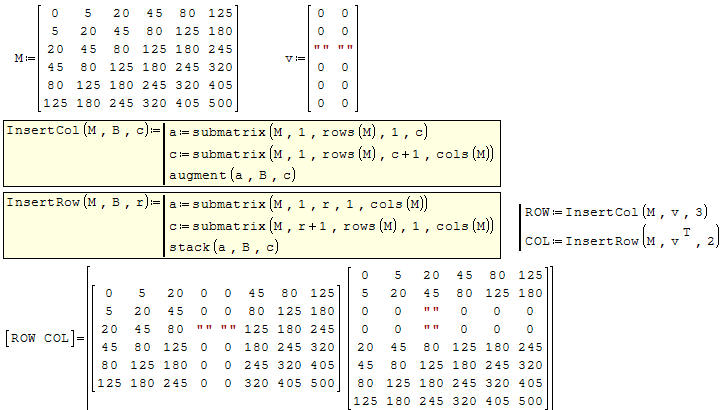

Adding a row or column in Mathcad, mid Matrix, was simple. In SMath, I cannot copy portions of the matrix to move the information (all or nothing) as I've tri. Am I missing anything?

Easy/simple ... it's ADD not INSERT
Matrix -Insert Row or Column.sm (12,53 КиБ) скачан 1669 раз(а).
#5 Опубликовано: 12.04.2018 20:35:51
In SMath, I cannot copy portions of the matrix to move the information (all or nothing) ...
Simply => submatrix !

Here is a work around that works for me. I did NOT try it as an insert to column or row index 1 as I assume these exist. If those are needed, I guess we use augment. At the end of a matrix, we can just pull the handle. RS_Insert cols_rows to Matrices.smz (6,87 КиБ) скачан 1626 раз(а).

Pad(M,nc,nr) ... padding a matrix has the meaning centered [nc,nr] insertion,
reserved for Fourier 'ifft'... why did you remove it.
For common work, rater use InsertCol/InsertRow.
RS_Insert cols_rows to Matrices(1).sm (47,58 КиБ) скачан 1669 раз(а).
