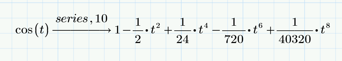

I can do in mathcad Prime
How to do it in SMath Studio?

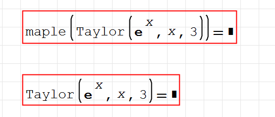

I just want to know how in the Smath, and cos(x) is just a simple example, it doen't necessarily mean I will use Taylor series for cos(x).
I found Taylor, but I don't know why it doesn't work.
#4 Опубликовано: 09.01.2021 12:00:35
simply not cracked in Smath ... from what I tried.

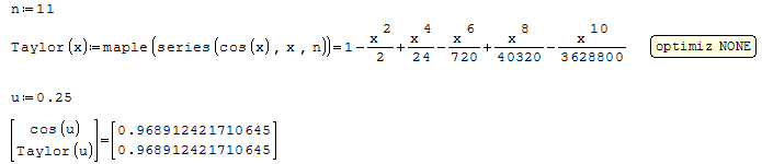

#5 Опубликовано: 09.01.2021 12:10:52
Alvaro Diaz Falconi
Alvaro Diaz Falconi
Hi. First, because "Taylor" isn't the maple command, it is "taylor", in lowercase. Second, because maple returns the answer with an "O" notation. You can use convert/polynom to get a result that SMath can handle.
SMath' maple plugin use version 6; here you can find two maple manuals, but for maple 7: https://www.maplesoft.com/documentation_center/history.aspx
