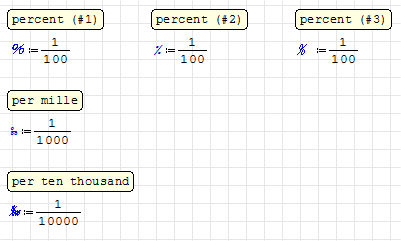

#1 Опубликовано: 30.06.2013 12:16:01
An old personal snippet, revisited.
snippet shortcut: percent

Simply great! I tried that and did not find appropriate characters.
If you want to have these units built-in, then replace the file units.xml in subdirectory "entries" of your smath installation.

Some of the unicode symbols don't show up correctly in my installation (mkraska portable version). See picture.

Seem that your "courier new" font is not updated...
Try looking here and here (with the same machine) if you have the same issue.
BTW I hope that hereafter the standard % sign will be unlocked by Andrey as an official unit. If this is not possible the alternative could be to have a "symbolical" function perc(1) for the LHS (like sum(), diff(), int(), etc..., where the function is converted as a drawn symbol with a placeholder - like in the picture attached below), and a new "percentual" item in the "fractions" context menu for the RHS (something auspicable also for the imaginary form: [MATH eng]e^{i*θ}[/MATH])
