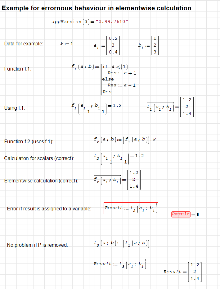

the (very smart) element-wise calculation seems to be buggy if applied to nested functions. The result can be calculated correctly, but cannot be assigned to a new variable. I found this issue in a complex calculation and simplified it to the attached problem:
- A first function uses an if-statement to calculate the result
- A second funtion calls the first function and multiplies the result with "1"
If either the if-statement or the multiplication is removed, everything works fine. This seems to be strange...
Used SMath-version: 0.99.7610, but also with current Beta-version 0.99.7804
For own tests: TestElem.sm (11,01 КиБ) скачан 1443 раз(а).

Use the function eval()
eval.sm (11,99 КиБ) скачан 1487 раз(а).

Seems to work! Thank you for your fast response!
