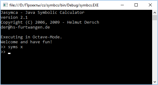

Source code was automaticaly ported from java to c#. If I'll find some time, we will have another small symbolic engine (maybe embedded in SMath).

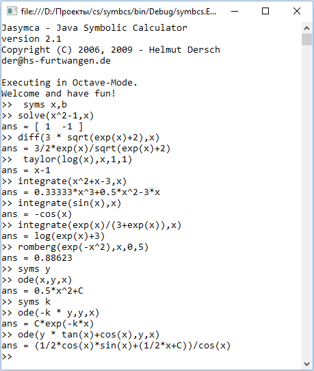

Updated ( github ).
The project can be compiled, but still does not work as expected.
#7 Опубликовано: 08.02.2019 11:14:39
1 534 сообщений из 1 850 понравились пользователям.

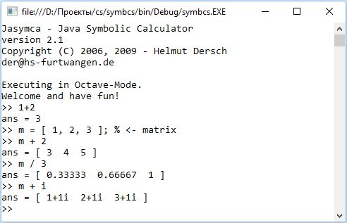

Simple calculations now work.
Alvaro 08.02.2019 15:18:00
#8 Опубликовано: 08.02.2019 19:05:16
More functions.

Binaries added to the repository.
exit + [ENTER] or [Ctrl] + [c] - Exit.
