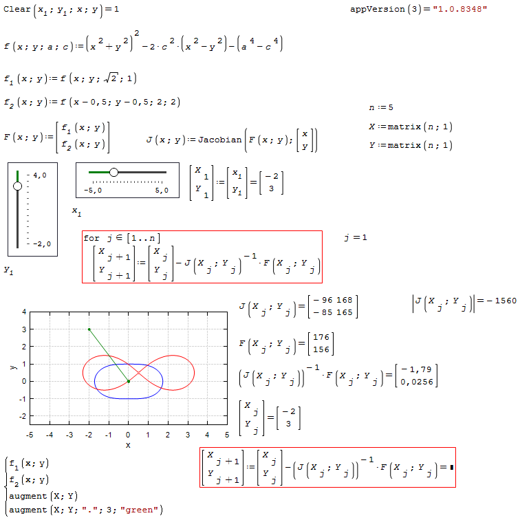

I cannot use the roots function and must use one old good simple method by Newton.
What can you say about it?
Newton-Eng.docx (1,07 МиБ) скачан 943 раз(а).

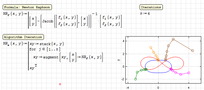

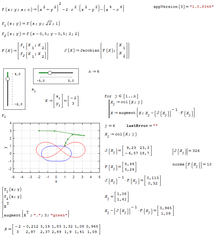

I had problems when reproducing your 2D version. Depending on initial guess I got errors "requested matrix element does not exist". The situation seemed to improve a little by pre-allocating the vectors X and Y yet it didn't become really robust.
So instead of assigning to j+1 elements I used augment() to add new points to the iteration history.
This is the original version:
Newton2D.sm (21,4 КиБ) скачан 1468 раз(а).
And this is the modified version.
Newton2Da.sm (19,03 КиБ) скачан 1597 раз(а).

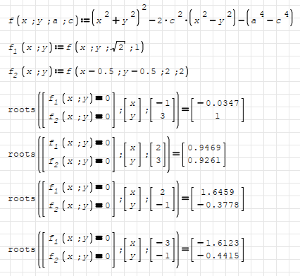

... can't find 2nd root
2nd root confirmed exact.
Solve(f,q,x0,x1,TOL) Copy.sm (162,62 КиБ) скачан 1584 раз(а).

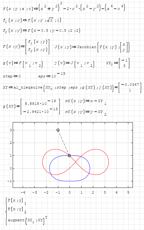

#4 Опубликовано: 09.04.2023 14:33:35
Tried to solve your functions with al_nleqsolve().
Newton.sm (13,85 КиБ) скачан 1509 раз(а).

#7 Опубликовано: 10.04.2023 16:21:38
Actually, you can.
