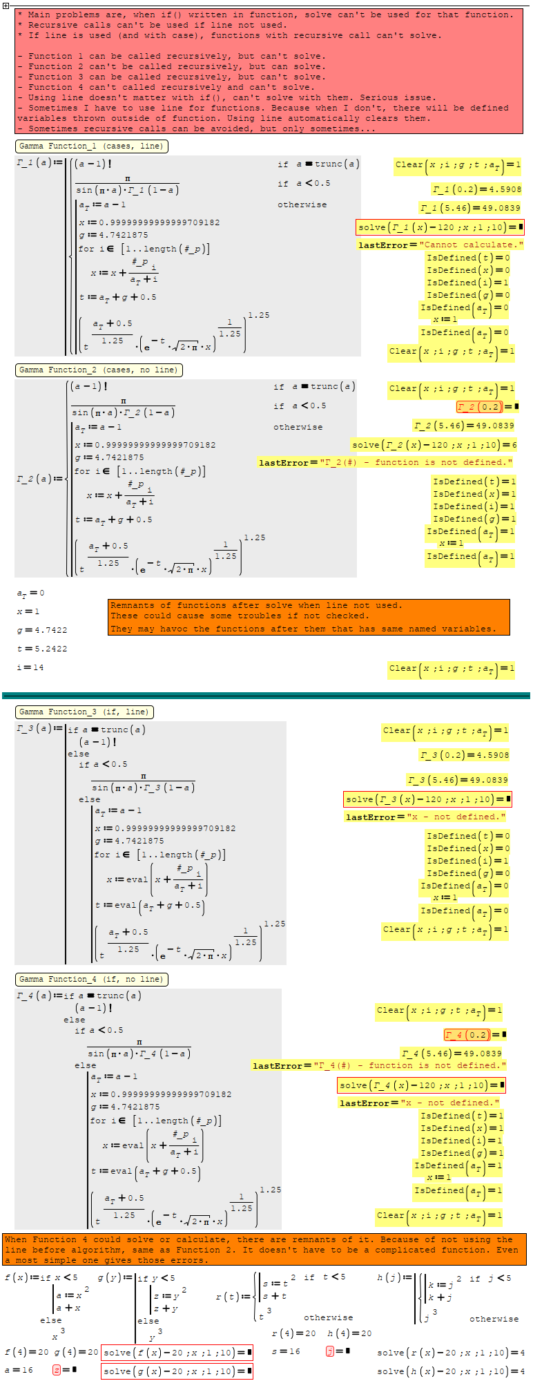

Update of statement:

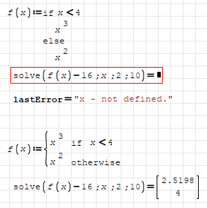

solve(), roots(), FindRoot() doesn't like if() function.
However, they can solve when cases() used instead of if().
#2 Опубликовано: 10.06.2021 23:36:37
I have diagnosed the symptoms with solve bug.
Made a page about this and tried to explain with detail.
somebugs.sm (54,72 КиБ) скачан 1514 раз(а).
somebugs.pdf (522,2 КиБ) скачан 757 раз(а).
Andrey Ivashov 11.06.2021 04:06:00, NDTM Amarasekera 11.06.2021 22:44:00

solve(), roots(), FindRoot() doesn't like if statement.
if/else was reported SS 5346.
Davide added if/otherwise SS 6179

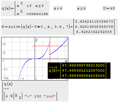

Here some notes about my opinion of how to work with piecewise continuous functions.
Piecewise.sm (45,64 КиБ) скачан 1490 раз(а).
Piecewise.pdf (184,98 КиБ) скачан 1200 раз(а).
#5 Опубликовано: 12.06.2021 15:24:02
IMHO, its logical solving piece wise discontinuous,
solve piece wise as well for productive classroom.
Page3 Solve Discontinuous.sm (5,27 КиБ) скачан 1662 раз(а).
