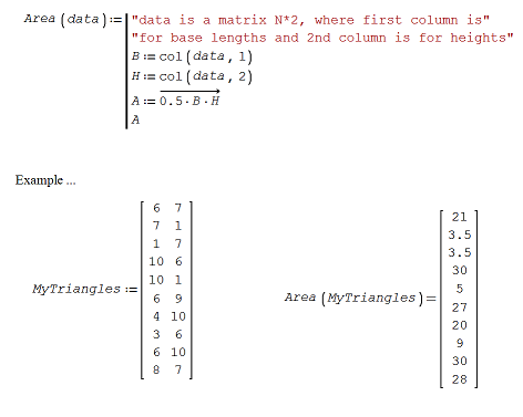

Good morning, my dears, could you help me? Recently, I have been learning programming in smath. My question is whether it is possible to make a multiple input in a repetition structure, whether it is a For... That is, an example if I had several geometric figures, for example, a triangle with different measurements, let's put a number that is 100 triangles with different measurements and I would like to program with the help of a repetition structure to instruct the dimensions of each triangle to find its area
Example
For I from 1 to N Do
Input(B, H) ;
Area_(I)=0.5*B*H
End;
Is there a way to do this in smath?

Hi Danuko, maybe an easy way to do you need is program a simple function and define the input as a matrix:
and here is the file: TriangleAreas.sm (5,6 КиБ) скачан 1304 раз(а).
Best,
Oscar

I wonder whether you really want to input hundred of triangle specifications inside SMath.
Using matrices for input usually is a nightmare because you neither can insert rows nor can you delete ones without resorting to some programming.
You could, however, build a sort of editor with append, insert, delete functions for the data storage.
I'd prefer a multicolumn text file (e.g. csv format) and the use of the importData() function.
