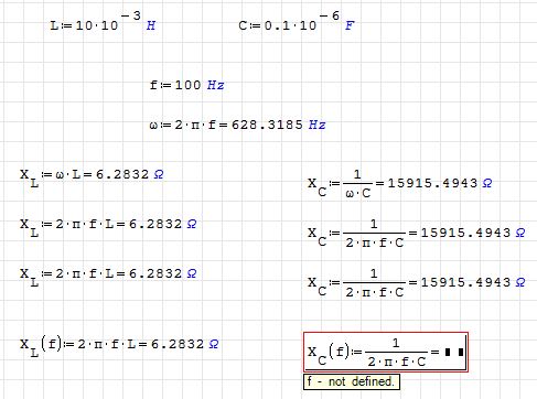

I am getting the following:

Hi Basile.
That's is the expected way to work with smath.
To get the value of X.C you must to call the function after defining X.C with X.C(f)=

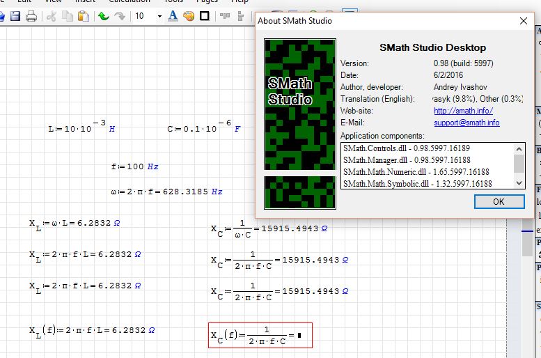

Depending which version, it could be. I guess that must to be an election from author, this is, if eval functions in that way. The "not evaluation" option, as the attached picture, it's ok for me.

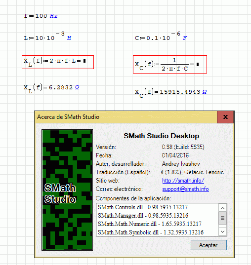

i am using

Hi Basile. I don't confusing. Reactances ( https://en.wikipedia.org/wiki/Electrical_reactance ) are reals and impedances ( https://en.wikipedia.org/wiki/Electrical_impedance ) are complexes. So X.L, X.C can't have j.
About the numerical evaluation for a function, check this old post: http://en.smath.info/forum/yaf_postst640_Function-as-a-program.aspx
In X.L, X.C definitions as functions, f must to be a local variable. X.L(f) -> (symb evaluation) must to set the answer with "f", not with "100 Hz". And the numerical evaluation X.L(f) = must to be in red, as f as local variable isn't defined.
As a choice of the program writer, and what you can see in the last post of the above referenced, you can set all the local variables as globals with f(x) = 1*(line ... ). Actually I'm not comfortable with that behavoir, but is the choice of Andrei.

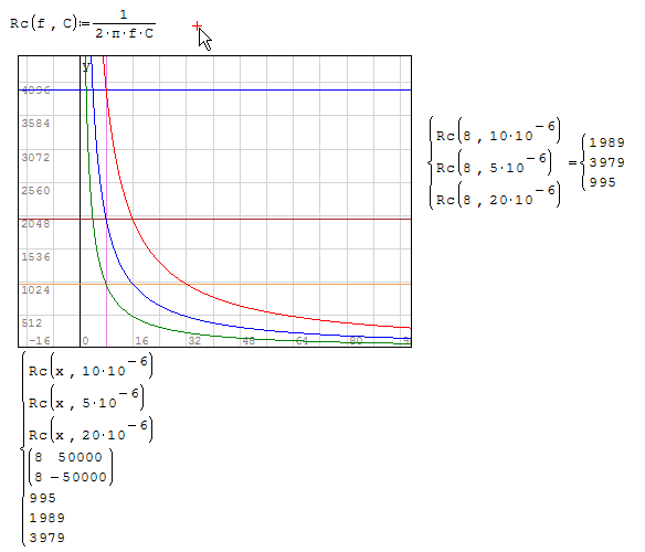

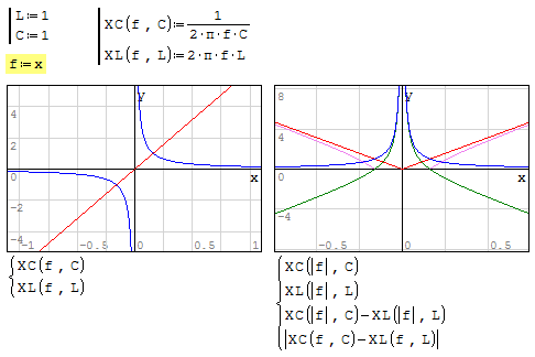

Just like this Basile, for a family of "C's"
at a fixed frequency 8 the magenta line.
On the plot, 'f' => 'x'.
#14 Опубликовано: 26.06.2016 14:59:10
Basile
Basile
Jean,

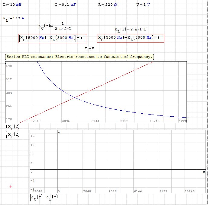

Yes, I can plot X.C(f) and X.L(f) but if I try to plot the difference or take the aritmetic difference does not work.
Please see figure and figure in post #1 on top, if it helps.

#17 Опубликовано: 27.06.2016 10:15:28
... project done Basile.
Circuit [LC].sm (18,41 КиБ) скачан 964 раз(а).
#18 Опубликовано: 27.06.2016 10:17:47
Note that I have removed the unit system because
"Units don't match" error mesage ... so: zap !

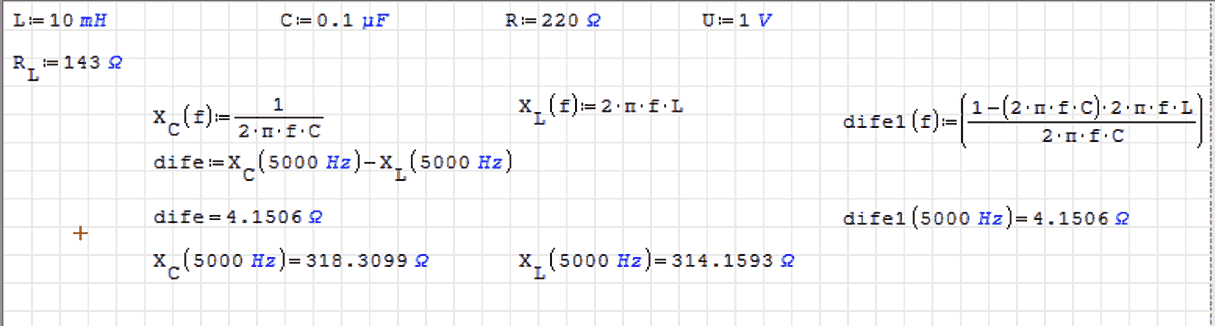

#20 Опубликовано: 27.06.2016 13:54:29
CBG
CBG
Redefining subtraction or function.
Carlos
test resonance_CBG.sm (10,1 КиБ) скачан 1118 раз(а).
