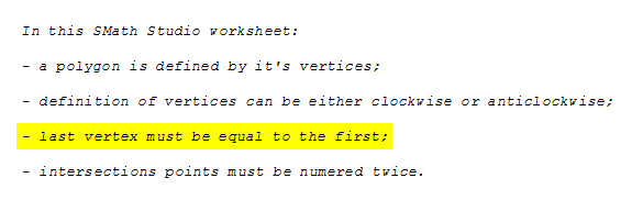

Does it work as well for open polygon ?
Nope, this worksheet was made just for closed polygons.
