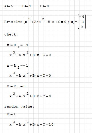

Hi
Could you help me with this? I tried to solve this cubic equation
A=solve(x^3+A*x^2+B*x+C=0,x)
where A=5, B=4, C=0, the answer give me only two roots 5 and 0, instead of three. The right answer is -1, 0, 5.
Could you explain me what can I do or what is wrong?
Thanks
#30 Опубликовано: 16.04.2015 11:44:55
No issues here
#31 Опубликовано: 16.04.2015 15:44:11
robinson
robinson
Thank-you Davide
I downloaded the file, but something is wrong because, I only saw two roots
cubic 1
However with other values is ok
cubic2
Robinson
#32 Опубликовано: 16.04.2015 18:20:16
I see... BTW also the cloud version gives 3 roots
Yuo can try to check if something is different in the global settings (Tools > Options... > Calculation)
#33 Опубликовано: 16.04.2015 20:09:42
robinson
robinson
Now is working. I changed Roots (range).
Thank you for your help

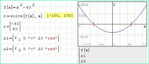

Here are your two plots c/w the roots shown on graph.
I have used the 'Solve Quick' in separate sheets not
to confuse solve[f(x),x] with the two differents
search range. Handling graphs are very easy, just a
matter of adjusting each direction [X,Y] separately.
Your solve with bracketed search range is perfect too !

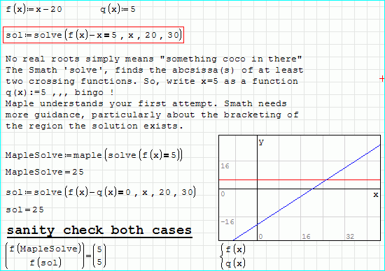

#39 Опубликовано: 20.08.2015 23:28:50
Collab,
Your turmoil is solved. Always plot before you attempt more maths.
