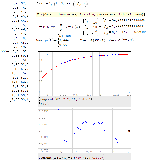

Demo for usage of the Fit() function (Maxima)
Genfit%20Thermal%20Insulation_Kr.sm (9 КиБ) скачан 89 раз(а).
