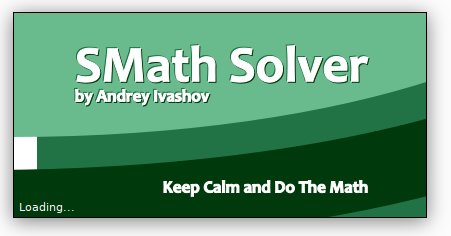

I downloaded SMath Studio AppImage from the website on ubuntu 22.04. Whenever I open it, it loads that green loading box attached below then it crashes. Any help please?. Thanks in advance
#2 Опубликовано: 09.02.2023 08:28:22
Try to run with sudo.
Whether appimage or regular, it won't run without sudo.
Well it will, but you must try a lot of times to make it run.
A link to a thread for further examination
This is a mono bug specific to debian distros except for one.
It is related with glibc and kernel version I suppose.
As far as I know due to my experience, only Debian based
distro I could run SMath without sudo is MXLinux (ahs).
If SMath doesn't run even, please run it under a terminal.
And post terminal output here, maybe it is a faulty plugin.

I created account on this forum only to write that if You install in Ubuntu 22.04:
libmono-cil-dev
libmono-db2-1.0-cil
mono-dbg
mono-devel
mono-tools-devel
then it should work without sudo. This is some bug within mono and installing mono debugging allows it to run apparently.
