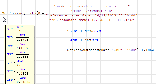

Hi all,
Here there is a plugin to have currencies and exchange rates in SMath Studio.
Infos:
Functions:
  • SetCurrencyUnits(1), SetCurrencyUnits(2): extends SMath Studio with currency units. When an internet connection is available, exchange rates are kept updated using the ECB reference rates (internet connection not required but useful);
    Цитата
    The reference rates are usually updated by 3 p.m. C.E.T. They are based on a regular daily concertation procedure between central banks across Europe and worldwide, which normally takes place at 2.15 p.m. CET.
  • GetYahooExchangeRate(2): get a wide set of exchange rates from Yahoo Finance (internet connection required); service discontinued by Yahoo
>>> PLEASE REPORT IN THIS TOPIC ANY ISSUE, MORE DETAILED AS POSSIBLE <<<

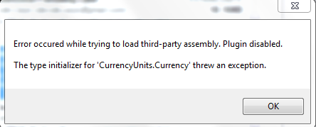

Unfortunately Davide, this does not work for me (Win7 x64). Plugin refuses to install properly.

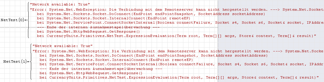

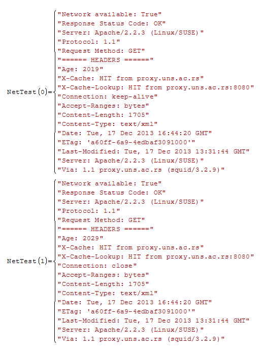

Try again, I've made some changes... If doesn't work try NetTest(0) and NetTest(1) and post a screenshot
very strange... try again with this update; if doens't work got to %APPDATA%\SMath\Debug\CurrencyUnits and post the log file

#8 Опубликовано: 17.12.2013 08:41:47
Failed again
Here is the log file
log.txt (1 КиБ) скачан 111 раз(а).
#9 Опубликовано: 17.12.2013 11:09:29
The results were overly wide, thus i cut them.
seems a proxy/firewall authorization problem... I suppose that NetTest("http://www.google.com") and NetTest("http://www.google.de") will produce the same results
Failed again
I've made another little modification, could you try again?
#10 Опубликовано: 17.12.2013 13:31:12
It seems that this plugin is not going to install into the Martins' unofficial build. I figured out by the second line of the log file.
I tried it on the official one and it seems to be Ok
Davide Carpi 17.12.2013 13:50:00
#11 Опубликовано: 17.12.2013 13:52:02
thank you Radovan, now I understand
the plugin looks for the files in the %APPDATA% folder, I'll try to fix it
[EDIT] UPDATED: this version should work properly both in the official and the unofficial versions

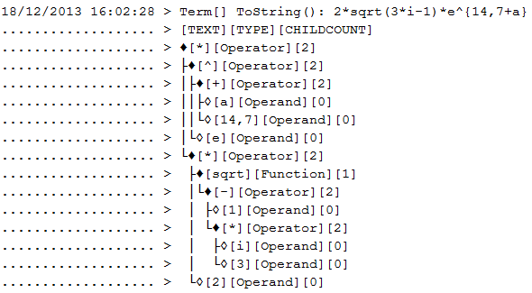

#14 Опубликовано: 17.12.2013 22:14:35
UPDATED
- error handling: LOGs will be placed in the relative "extensions\debug\CurrencyUnits" folder (so the portable version has a portable debug path)
- For developers only: added a log tool to output a Term[] tree representation (see the CurrencyUnits Implementer.cs).
