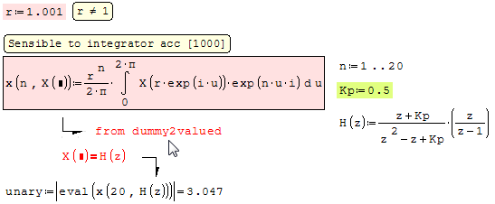

Can't manage this otherwise than shitting bricks !
Solution is welcomed ... Thanks
Done otherwise to rescue the Document.

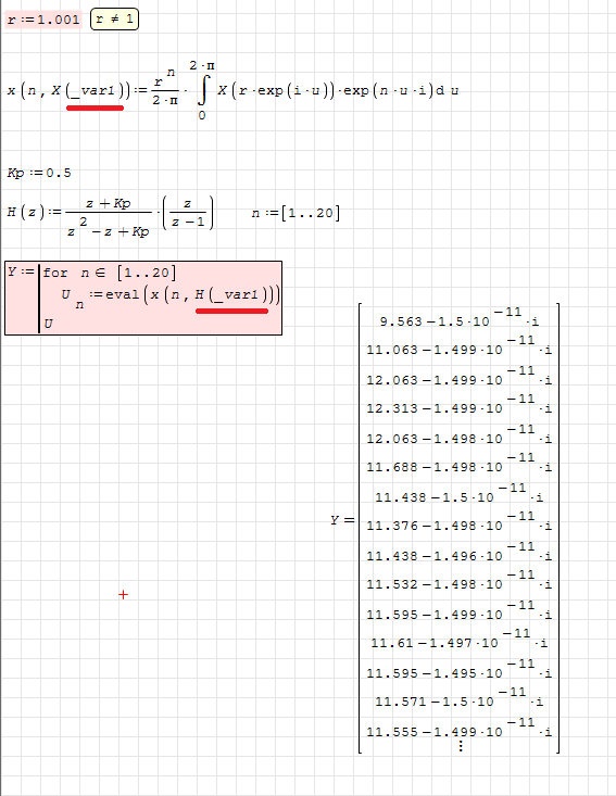

In order to pass functions as inputs to other functions you need to declare it as such and pass a "dummy" variable. See following.
There is still a problem in that it is not evaluating properly, I believe.

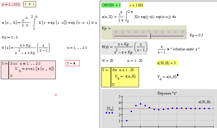

#4 Опубликовано: 10.12.2018 20:29:36
fixed
Inst_PID Discrete Schema EXAMPLE_6 - fixed.sm (46,19 КиБ) скачан 1215 раз(а).

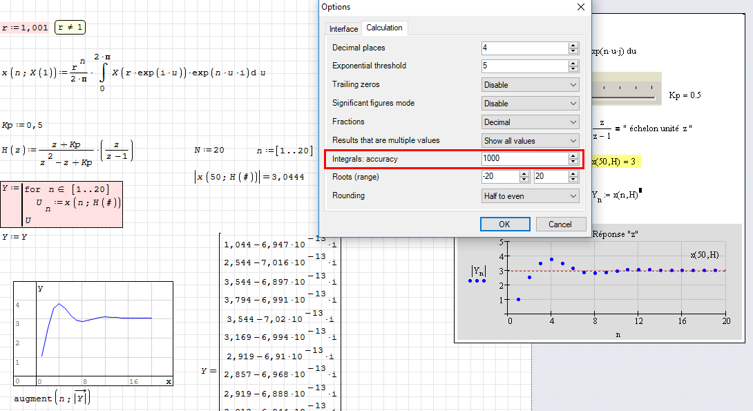

2018-12-11 00_34_33-SMath Studio - [Inst_PID Discrete Schema EXAMPLE_6 - fixed.sm].png
  • removed answer requested for first argument of the last system;
  • used f(number_of_arguments) function of function argument (more elegant, point out that the variable name doesn't matter);
P.S. To obtain similar results, change the integration accuracy to something higher than 100

As simple as that: x(n,X(▄)) ... simply the native dummy argument
big square imitation Alt220 ... try it.

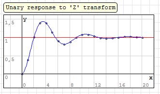

#7 Опубликовано: 11.12.2018 01:04:47
... like this:

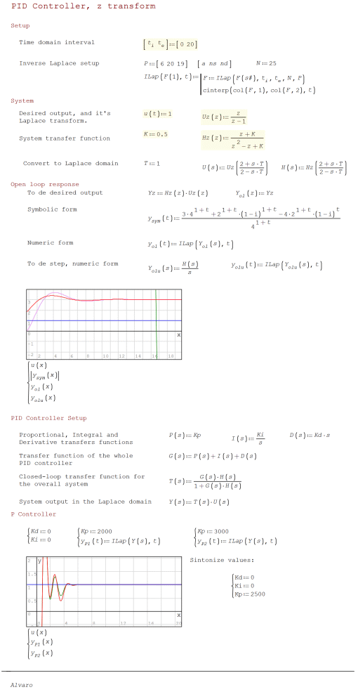

Hi. This is the setup for use inverse laplace transform for numerically evaluate the response for a system in z domain.
pid_controler z.sm (50 КиБ) скачан 1193 раз(а).
