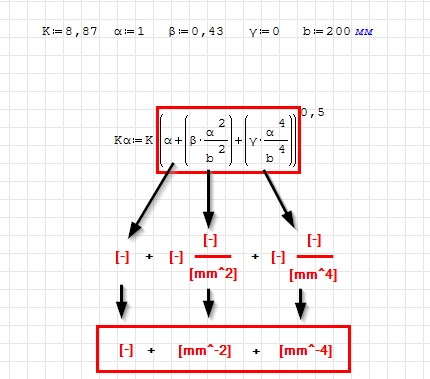

#2 Опубликовано: 01.02.2015 09:39:04
The error seems correct. Just make a dimensional analysis on α+(β*{α^2}/{b^2})+(γ*{α^4}/{b^4})
You sum something dimensionless with 1/мм^2 and 1/мм^4

#4 Опубликовано: 02.02.2015 20:11:26
Maybe the attached picture helps a little bit more to understand the issue...
As stated previously, you can't sum apples and oranges; therefore the error message seems consistent...
