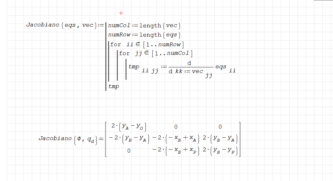

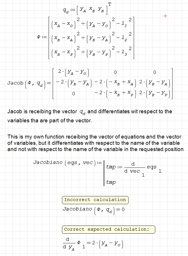

This is to use the "diff" function to differentiate an expression with respect to the variable that is an element of a vector, just like the "Jacob" function does. Here is an example:
Hope you can help me and tell me how to derive a expression with respect to the correct varible name.

I could not tell you why this works.. but assigning another variable the value of q.d[i seems to work.
Jacobiano.sm (8 КиБ) скачан 70 раз(а).

I could not tell you why this works.. but assigning another variable the value of q.d[I] seems to work.
Thank you very much!, it works fine. I am also wandering why, but it works!

Something like this ?
Maths Jacobian Example.sm (7 КиБ) скачан 64 раз(а).
Thank you very much, the solution proposed by alyles works fine.
