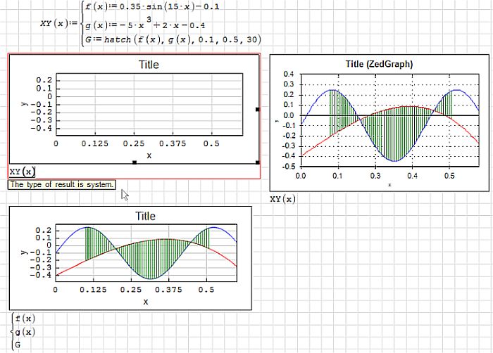

The recent update to X-Y Plot plugin, throws an error to some of my earlier sm files.
The attached file too (downloaded earlier) shows same error.
2DPlots Hatch Demo [Martin, Alvaro] (1).sm (23,02 КиБ) скачан 1066 раз(а).

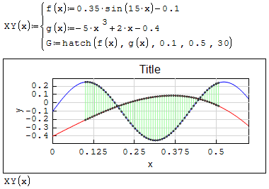

Try this XY(x). If still kaput: try reset the X_Y plot.
From versions to versions X_Y may have lost settings.

NDTM Amarasekera
NDTM Amarasekera
Thank you Jean. But the error persists. See the error message
However, no problem with ZedGraph in both cases
