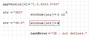

This is honestly such a lifesaver for moving data between SMath and Excel. Even with the occasional formatting quirks with negative values or scientific notation, it’s much faster than manual entry. I've found that using a quick 'str2num' or 'strrep' usually clears up those string issues in a pinch.
