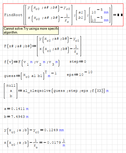

Can not solve a system of two equations
Can not solve a system of two equations - Help me please - Сообщения

#2 Опубликовано: 08.10.2023 08:58:36
roots supports a single argument
Valery Ochkov 08.10.2023 09:05:00
#3 Опубликовано: 08.10.2023 09:04:57
Valery Ochkov
Valery Ochkov
55 сообщений из 633 понравились пользователям.
#4 Опубликовано: 08.10.2023 13:51:08
You don't have to eliminate units.
There are tricks to use them in solvers.
This is the best I could get.
Maybe a pro user can help you better.
roots() supports multiple argument btw.
Your equations has derivative.
Possibly reason of error by conventional solvers.
roots(), FindRoot(), solve() mostly doesn't like it.
CP-Cyrcle_solved.sm (32 КиБ) скачан 67 раз(а).
Oscar Campo 08.10.2023 22:44:00, Valery Ochkov 09.10.2023 05:52:00

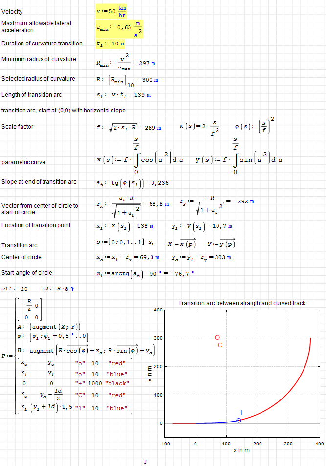

#5 Опубликовано: 09.10.2023 05:44:58
1226 сообщений из 2151 понравились пользователям.
This is a version without solving equations. The curvature is known as a function of the path length.
02 Ubergangsbogen.sm (80 КиБ) скачан 71 раз(а).
Valery Ochkov 09.10.2023 05:52:00, Oscar Campo 09.10.2023 07:39:00
