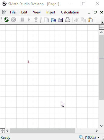

Implementation is in progress, but here is what we have for now:
I believe it will make worksheets debugging much easier!

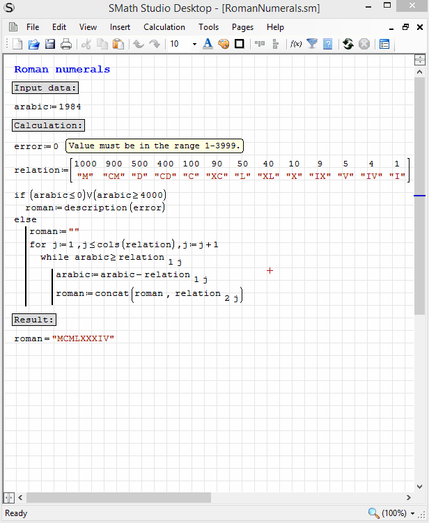

The debug delivered with Smath official release 5346 is not bad at all:
divide by zero, arays don't match, undefined ...result is above
One debug puzzled me for a while, explain: sometimes, when plotting
user function, you will get an underscore followed by a number
_ -X.XXXXXX .... it indicates non computable number

Latest SMath Studio beta released: http://en.smath.info/forum/yaf_postst7659_SMath-Studio-0-98-5997--02-June-2016.aspx
One can play with debugging functionality there.
Please note:
  • Buttons in main toolbar are rearranged;
  • Super handy Pause button implemented - you can found a place where calculation in progress right now in one click! Previously it was absolutely impossible for large worksheets;
  • Watch panel displays changed values in red - it makes much easier to understand what was changed since last step;
  • Breakpoints can be set/removed before calculation started and also when calculation is already in progress;
  • Vertical scrollbar improved to show locations of the regions with breakpoints.
I will slightly improve debugging functionality in future releases and will fix some bugs, but it looks for me very powerful even today!
