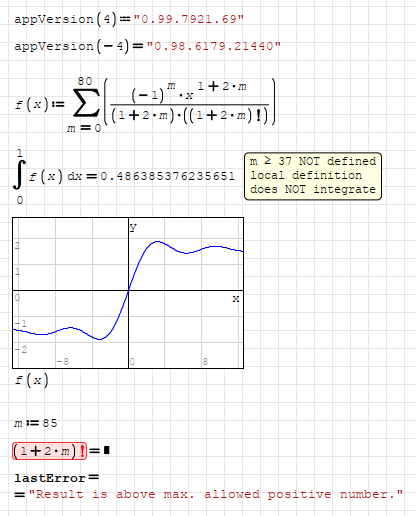

This bug existed SS 5346 ... SS 6179
SineIntegral.sm (4 КиБ) скачан 70 раз(а).
#2 Опубликовано: 17.02.2022 12:42:51
Well, not anymore.
Stop whimpering for 5 year old version of SMath. (v0.98.6179)
Guess what, this kind of bugs are being corrected.
AND NEW VERSIONS ARE RELEASED FOR THOSE CORRECTIONS.
There is no practice of releasing a new version with same version number.
You should just keep installing latest stable releases.
And it is obvious you function give an error.
That factorial is above max. number allowed.

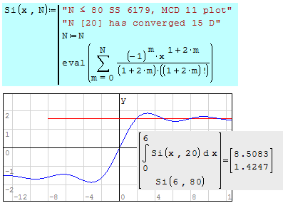

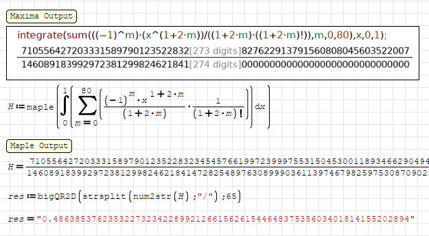

First he whine about a calculation of 5 year old version bug which is fixed.
And now he is complaining about SMath integration is not accurate.
Well, it is known by all of experienced users.
Maybe it is not a bug, more like a limitation.
SMath is using IEEE754 double, it won't accurately make this 334 decimals division.
If he want to integrate that accurate, than he should use maple or maxima.
By the way, I can get accurate more than 500 digit with same functions.
If he wants floating point, let me see if Jean can pass this.
And his function is wrong at 15th digit.

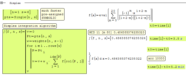

By same token, Sine Integral has applications in
Process Control & Instrumentation [critical ramp set point].
Cheers ... Jean.

A much easier calculation that Jean can stop weeping.
Well, I doubt what I say.
João Felipe Seráfico Melo 17.02.2022 22:37:00
