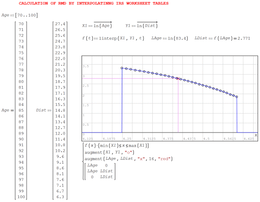

Sorry to be so slow on Smath. Some thing work like Mathcad and some don't. I need help with the correct syntax for the interpolation function linterp. I have tired all combinations of syntax that I can think of and none work in the attached Smath file.
Help would be appreciated.

Some thing work like Mathcad and some don't.I need help with the correct syntax for the interpolation function linterp.
Read carefully: linterp, cinterp are 1/1 Mathcad
Smath ainterp has special virtues not found in Mathcad.
Smath linterp, cinterp, ainterp are 1/1 Mathcad as interpolation.
but are 0/1 as scalar functions. In many instances, it is possible
to recast the problem in the form of infinitesimal analysis.
I found no way to render a_c_l interp scalar Mathcad style.
Though, I have the Mathcad code. Don't confuse yourself, a_c_l_interp
they plot on the canvas, i.e: they plot scalar.
scalar is a kernel internal vanishing iterator
Next question: please attach the Smath document.
#7 Опубликовано: 14.02.2019 21:53:35
Oops I meant this way to no success.
Sorry, I downloaded the other one.
Either blue/red will each have an extraordinary good model fit,
for further processing [deriv, int].

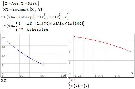

Hi. You can do some plots too.
RMD CALCULATION.sm (10,79 КиБ) скачан 1203 раз(а).

Just a note.
Pay attention to the plot by Alvaro. He uses often neded lele() function (Custom functions plugin) for checking if the value is in a range: Xmin<=x<=Xmax

Is this XY plot new? I find it really helpful.
RMD CALCULATION.sm (18,33 КиБ) скачан 1141 раз(а).
#18 Опубликовано: 15.02.2019 22:48:25
Is this XY plot new?I find it really helpful.
Not new, just from applied Smath features as in older SS 6179.
