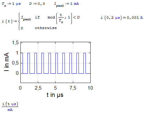

Hello SMATH Studio Experts!
Please see the attached example in MC15 that I cannot seem to get past the first graph of creating current pulses, thus can't move forward attempting to address the actual circuit analysis. The constant current pulses creating the resulting voltage waveform is the goal.
I welcome any suggestions/recommendations to convert the MC scheme to SMATH Studio.

The function is defined using the cases() function from the Customfunctions plugin.
Worksheet13.sm (5 КиБ) скачан 73 раз(а).

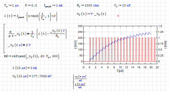

#3 Опубликовано: 09.08.2024 04:07:02
Thanks to Martin, I was able to move forward! R-C Network.sm (24 КиБ) скачан 77 раз(а).

#5 Опубликовано: 09.08.2024 22:32:50

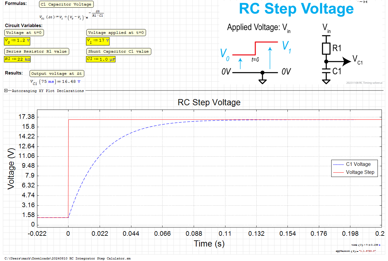

Apologies for this being a bit off-topic, but it is a good place to contribute given the content.
20240810 RC Integrator Step Calulator.sm (74 КиБ) скачан 76 раз(а).
