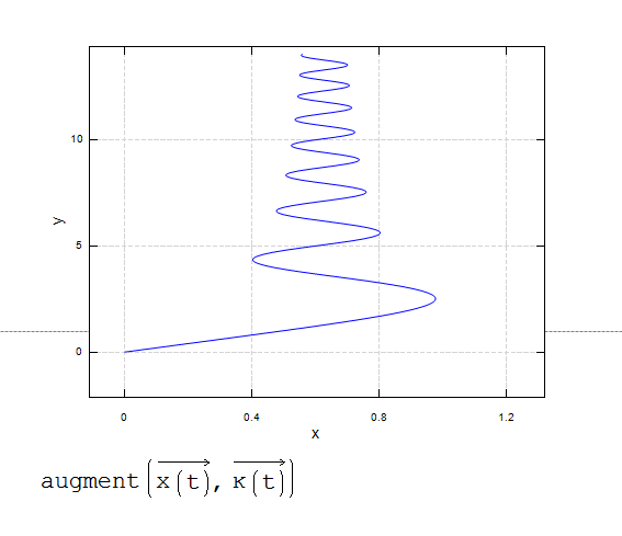

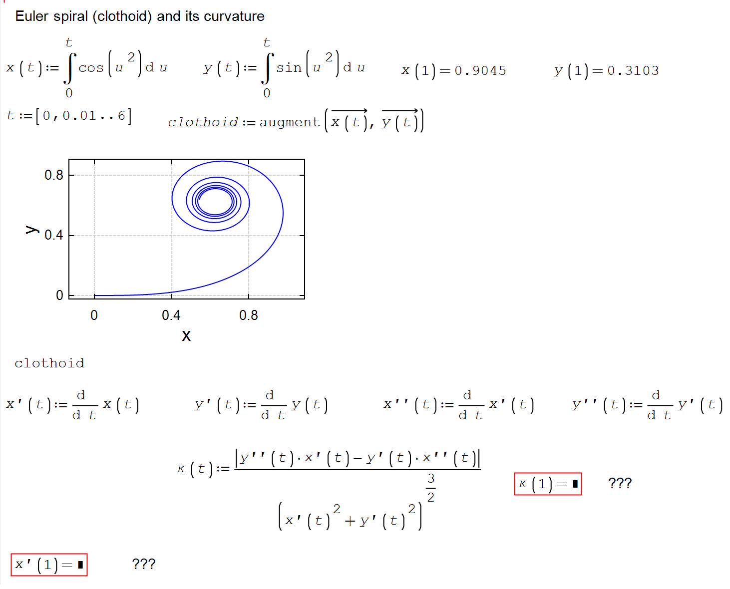

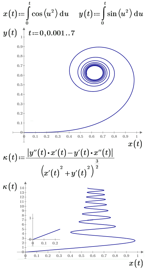

Why I can not to plot the Euler spiral curvature?

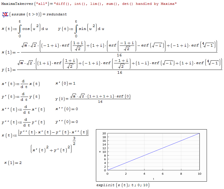

#2 Опубликовано: 14.11.2023 04:46:11
SMath native integration is a purely numerical procedure. Derivatives are symbolic ones. You would need to replace the symbolic derivatives by approximations.
Maxima can handle the derivatives. Funny enough, Maxima can't display the integral values x(t), y(t), neither can it plot them.
But you just asked for the curvature
Euler-spiral_Maxima.sm (28,89 КиБ) скачан 1433 раз(а).

#3 Опубликовано: 14.11.2023 04:53:38
Valery Ochkov
Valery Ochkov
Thanks, Martin.
No solution in pure SMath?

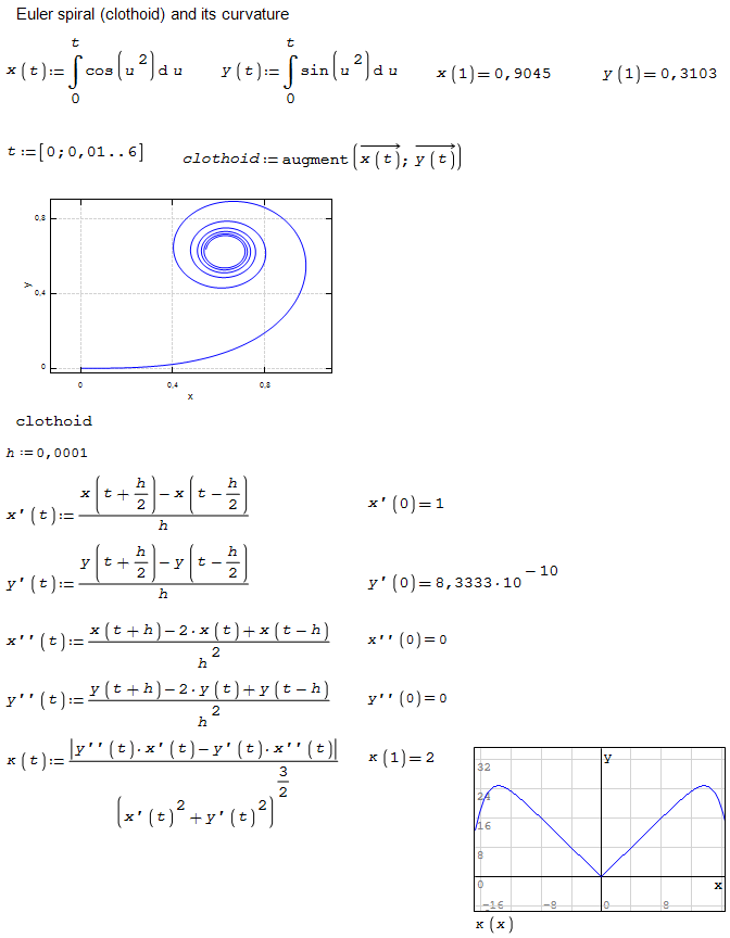

#4 Опубликовано: 14.11.2023 05:58:30

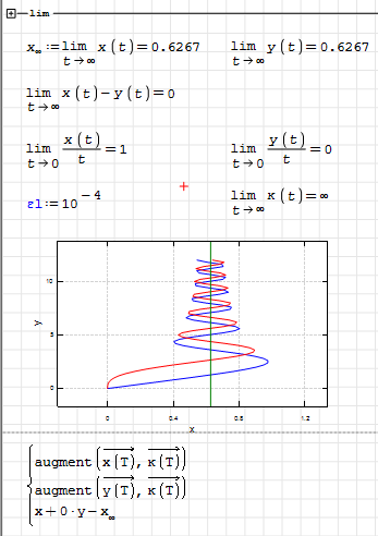

Here is a solution in pure (AKA Maxima-free) SMath.
The derivatives are replaced by difference quotients with a fixed perturbation h. Sooner or later this h is too big for a precise approximation, therefore, the value of the curvature deteriorates for large values of t.
Perhaps the fixed interval integrator also is to be blamed for the loss of precision.
Another M to patent?
Euler-spiral_Kr.sm (15,13 КиБ) скачан 1515 раз(а).

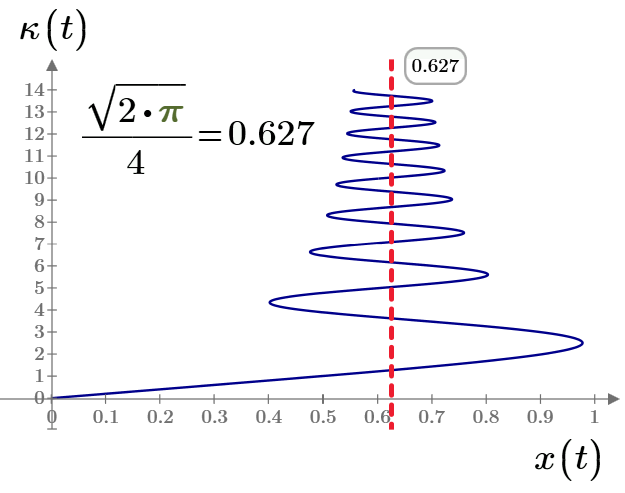

#5 Опубликовано: 14.11.2023 06:11:13
Hi. These are another two options.
1-10-Euler-spiral - option 1.sm (174,84 КиБ) скачан 1465 раз(а).
1-10-Euler-spiral - option 2.sm (176,58 КиБ) скачан 1452 раз(а).
Oscar Campo 14.11.2023 10:15:00, Valery Ochkov 14.11.2023 13:43:00

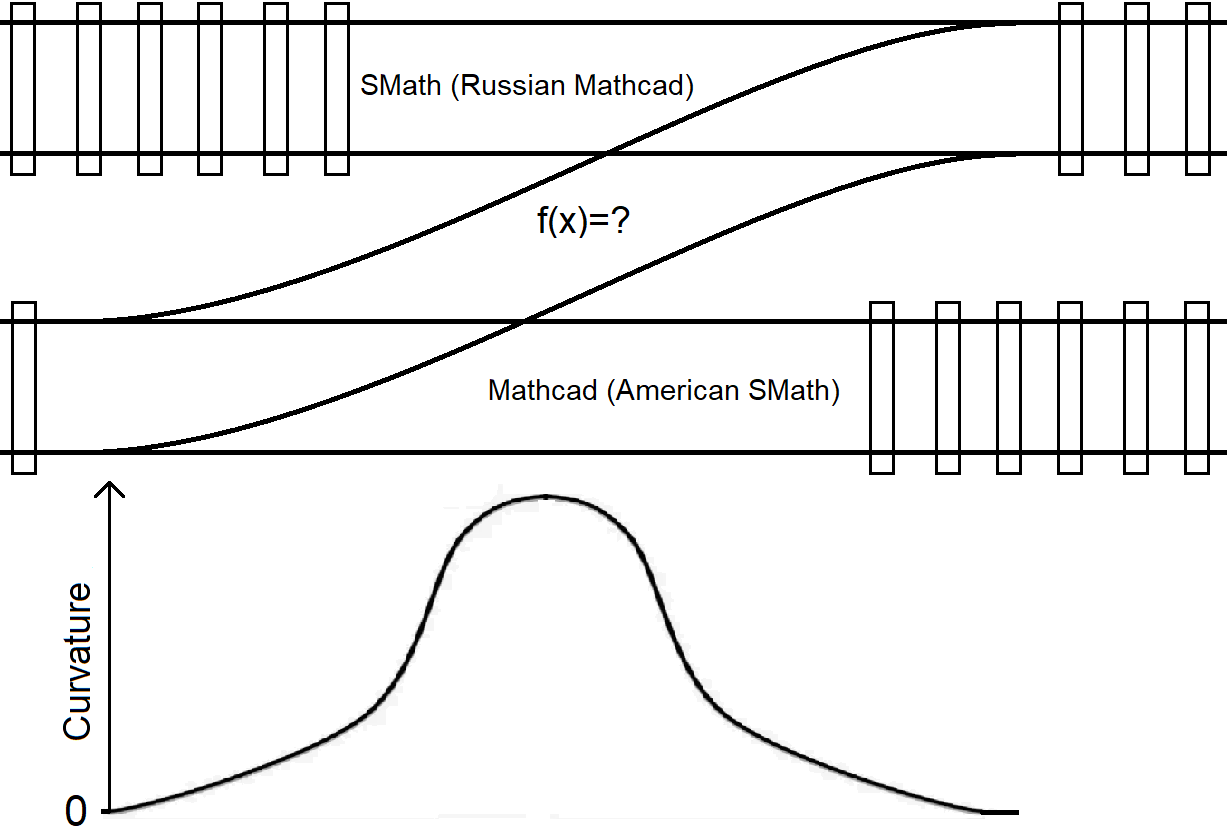

Euler spring

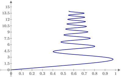

#13 Опубликовано: 15.11.2023 10:28:26
Hi. Using the numerical limit procedure from this post
1-10-Euler-spiral - option 2.sm (40,6 КиБ) скачан 1444 раз(а).
Valery Ochkov 15.11.2023 12:44:00

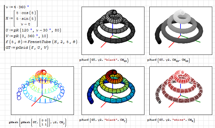

#17 Опубликовано: 15.11.2023 23:55:45
Nice picture. This is a conic helicoid.
HelliCone.sm (148,93 КиБ) скачан 1533 раз(а).
Oscar Campo 16.11.2023 00:16:00, Martin Kraska 16.11.2023 08:17:00

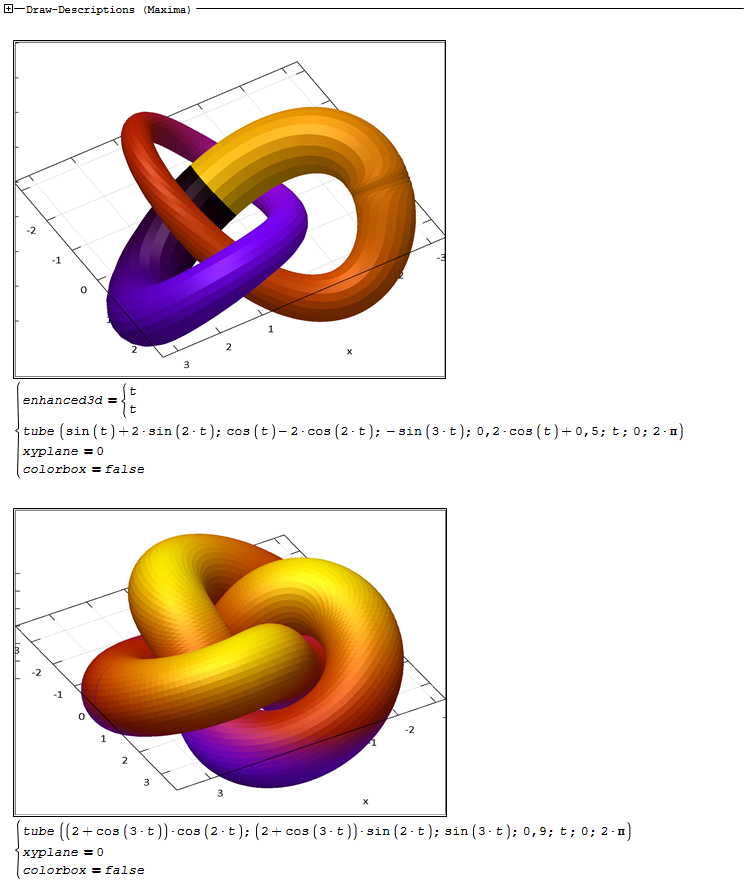

#18 Опубликовано: 16.11.2023 08:16:36
The plots are interactive (drag to rotate, Ctrl-Mousewheel to zoom). Yet, they are not really performant, takes approx. 3 seconds to update.
knots.sm (272,12 КиБ) скачан 1523 раз(а).

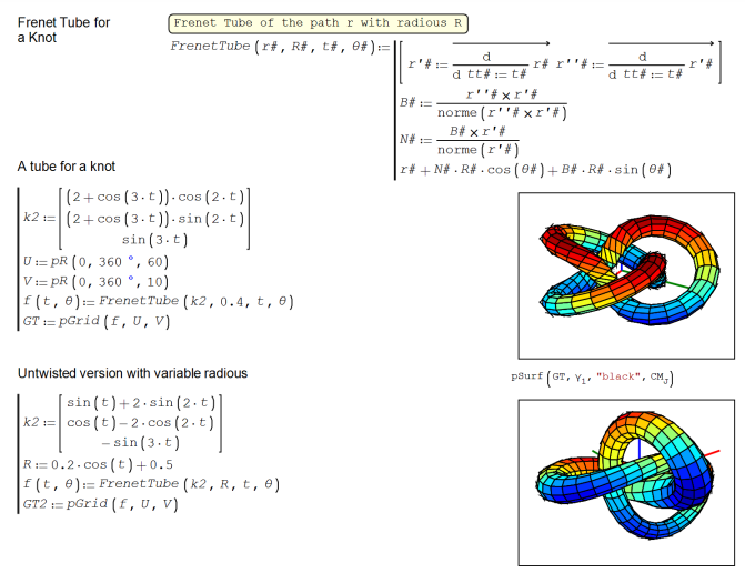

#19 Опубликовано: 16.11.2023 08:46:37
Valery Ochkov
Valery Ochkov
https://yandex.ru/video/preview/7434912311849987856
