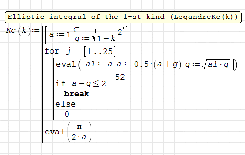

Discovered strange look of the for operator inside the function:
Wrote code outside, than copy-pasted it into the function.
Than it looks like that (look at Range2 inside for operator).
Andrey Ivashov 30.01.2018 16:10:00
#3 Опубликовано: 30.01.2018 16:16:42
Thank you! Fixed.

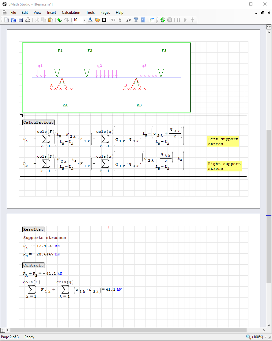

#6 Опубликовано: 01.02.2018 17:36:12
[USERLINK]omorr[/USERLINK], [USERLINK]mkraska[/USERLINK],
Of course switcher will be available on the most convenient place. Like this:
