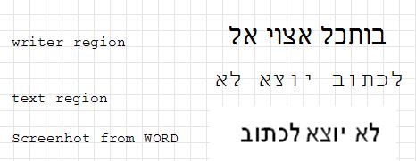

Hello friends,
Today I tried your program as alternative to very expensive mathcad, and meanwhile I trully enjoyed it.
There is only one issue that stopping me from using it daily: It doesn't work well with hebrew texts fields.
To easier explanation see picture attached bellow:
How can I manage this problem?
#2 Опубликовано: 10.12.2018 15:11:09
Hello [userlink]Eugene[/userlink],
this is because bidirectional text is not yet supported.
I guess that as for now one might use some logical-to-visual bidi converter, but I know isn't a good solution in the long run.
Okay, I understand.
Seems it is nothing left to me then to wait for it to be supported.
Anyway thank you for your replay.
