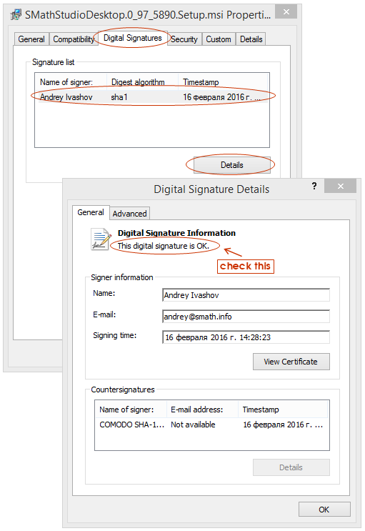

It is very easy to check this. Check Properties of SMathStudioDesktop.0_97_5890.Setup.msi file you have downloaded (using context menu) and check digital signature of this file like shown on the screenshot:
This is 100% guarantee that the file you have is the same as available on the official web-site.

I check Digital Signatures is correct but I can't see more details like your second image. See below:
Do you have another ideia about this problem ? If I have some virus in my system, is it necessary another way to I download Setup ?
