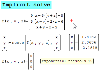

Implict solver works in the stable Smath 6179.

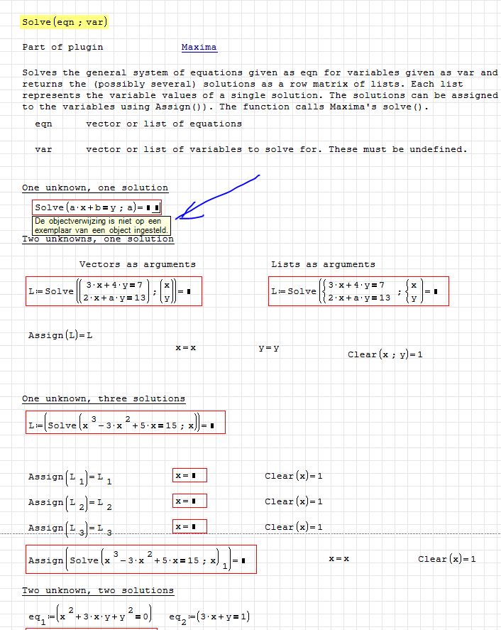

Many Thanks for the help sofar. I downloaded v14 + maxima en try to use the solve function, but I got the message as displayed in the enclosed file:no object reference.JPG
Translation of Dutch message: The reference of the object is not adjusted to an item of the object
What can be the problem ?
Another question: the solve option under the Calculation tab is grayed out. It seems I can not use this solve option. What can be the point ??
What is v14? I recommend to use the latest nightly build of SMath and Maxima, see http://en.smath.info/forum/yaf_postsm11095_Maxima-Plugin.aspx#post11095.

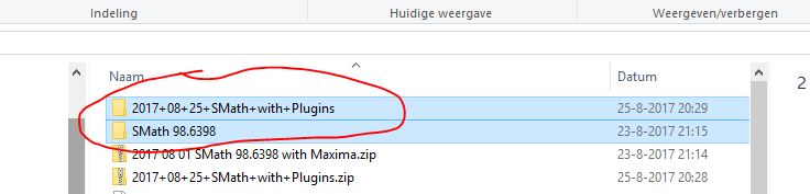

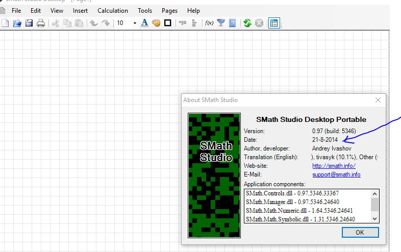

I use version 14 as is visible in :
I use windows 10 . Can that be the problem.
Do I have to do some installation settings to get maxima running ?

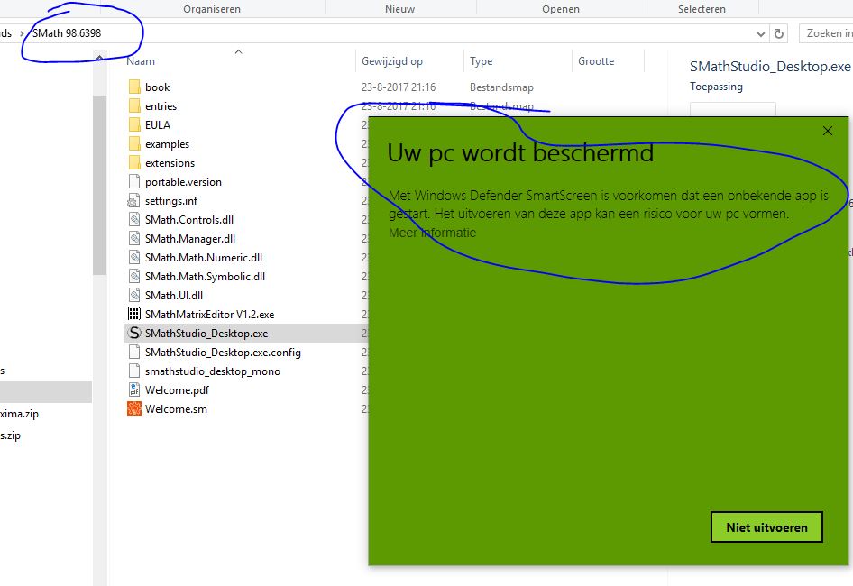

In two versions I downloaded and try to run , the following message appears:
The versions I downloaded are:
The strange thing is that my Windows Defender software is already disabled !!?
In this way I am not able to start Smath at all !
#13 Опубликовано: 25.08.2017 17:05:10
The only change I did to the executable was to set the 32 bit flag which is required for the Mathcad user library interface to work (Steamtables and Special math functions libs, userefi plugin). If you don't need this, then replace the executable in the portable distribution by the one in the LINUX version (yes, even if you are under win).
If that doesn't work you can still try the installation procedure described in http://en.smath.info/forum/yaf_postst2078_Maxima-Plugin.aspx. This exclusively uses original installers.
