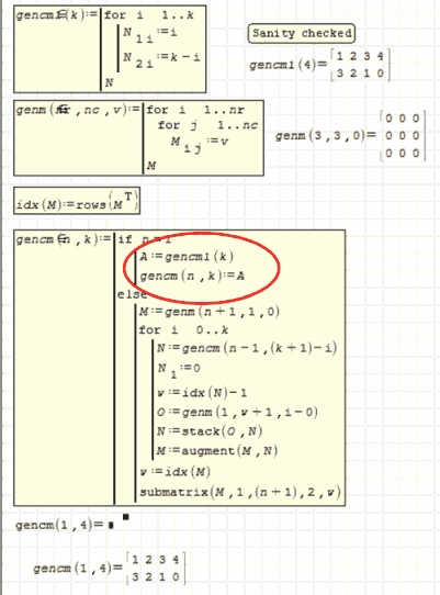

Up to this point, 'n-simplex' is not very successful.
This one is awaiting to be Doctored
Thanks in advance ... Jean
Maths Simplex Copy [3].sm (226,33 КиБ) скачан 886 раз(а).

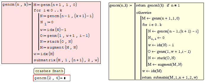

Here you have
  • fixed wrong instructions of exit point when n=1 (missing in the left side of the screenshot above BTW);
  • made initialization of local matrices of gencm1(), genm() because same names are used on a parent level;
  • missing a -1 in definition of O;
  • (optional) submatrix() made with ranged indices;
Maths Simplex_fix.sm (228,2 КиБ) скачан 1161 раз(а).
P.S. crash on infinite loops is a known bug: SS-2294
