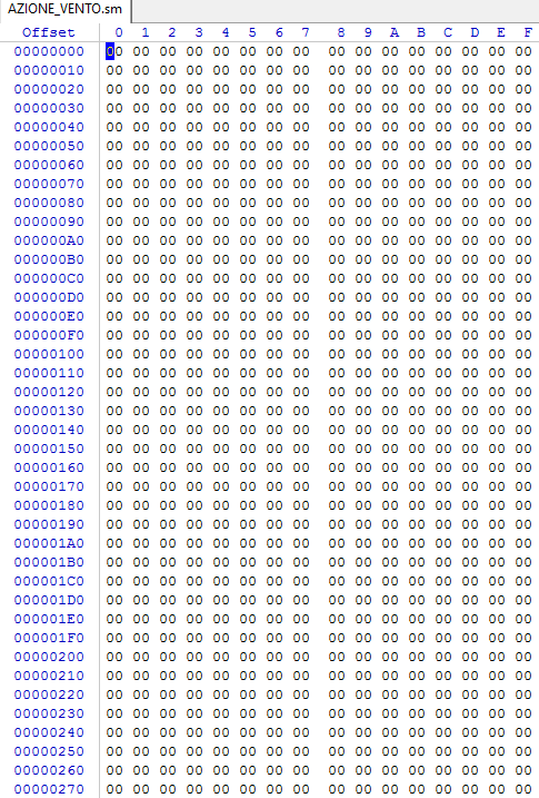

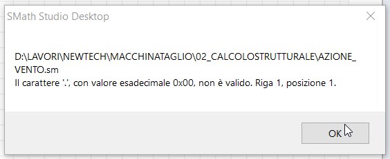

I've downloaded the latest version, but unfortunately I'still got an error during opening a file created with the old one.
Follow the screenshot....
basically says the "dot" character with hexadecimal value 0x00 at the first row is not valid....
Please someone should help me!

#2 Опубликовано: 15.11.2020 09:39:53
The file is completely filled with zero bytes. It is impossible to restore.
